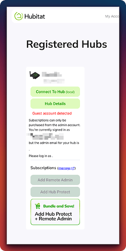

Hey all. I followed the directions to change my email associated with my account (create new account, add as new admin) but when I visit the my.hubitat.com page and log in with my NEW email, I see a red error saying there's a guest account associated. But the account it's showing is ".". When I click into the details, there's no place to see or even remove any of these phantom accounts. Any help would be appreciated. Thank you.

Well, looks like we have a mixed-case problem when replacing the admins :slight_smile: Your new account is all lower-case letters, but when you replaced the admin, you used a mix of letters. Since the account is case sensitive, the new admin account, as you entered it, doesn't exist. We will review the process behind the admin replacement, so others don't run into the same issue. Since I was looking at your account, I corrected the admin, so you don't have to do anything.
