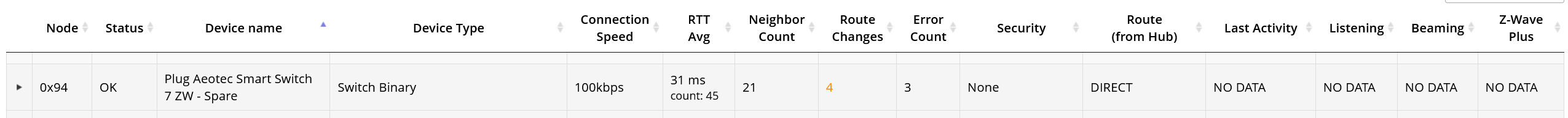

I have removed and installed this device many times. Each time, I get the NO DATA. Thoughts? Actually, I'm getting the same for 3 of those devices.
I get this when I add Fibaro Z Wave 500 devices to the C-8 using a Z Wave controller. After going through the rigmarole of including the Z Stick, including the device, rebooting the hub, refreshing the device, everything works but I'm left permanently with 'No Data' for some items. I seem to recall that a long time ago on here someone shared a way of fixing it by sending some command to the device. I can't locate the post now however.

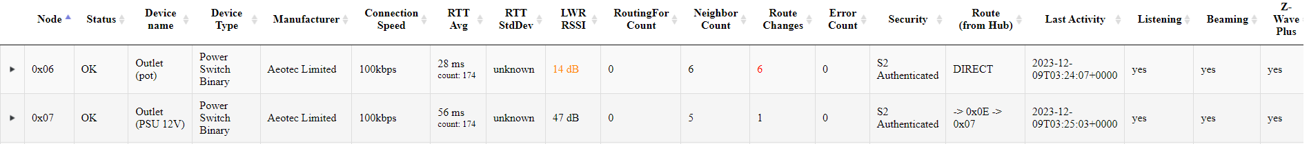

I have 4 of them on a C7 hub with S2 security. All are EU versions (F plug - ZW175-C). 3 are regular and one updated with unreleased firmware with fixes for some timed and threshold based reports and a clock-request-at-power-on fix.
Two 'original' units:
For how long devices were used after inclusion before you got this statistics? From what I had observed not all fields are populated right after inclusion.
The NO DATA seems permanent. The same with one of my Ring extenders. I have removed it, factory reset, and installed it several times with the same NO DATA result.

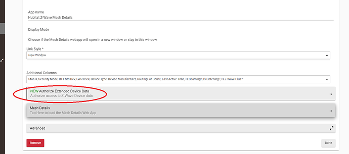

Have you added your devices of interest here?
That worked for all but one of my Aeotec switches. I removed it from Hubitat and re-installed it. Still the same NO DATA. Very odd that this switch is now the only one.
