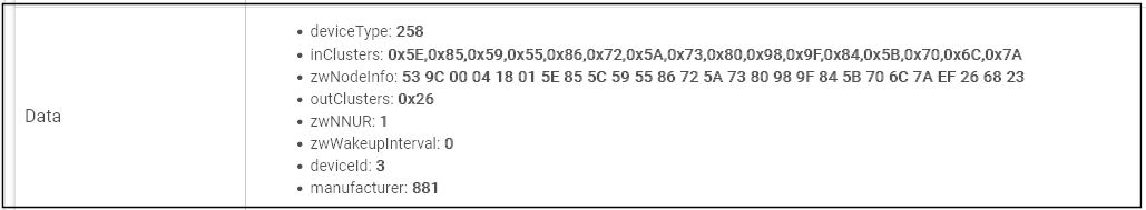

I wanted to check and do a firmware update. But both my Aeotoc button products (NanoMote and Quad) do not report hardware or firmware version.
Is the lack of firmware version reporting blocked in the Aeotec products is it a limitation of the device's Hubitat driver?
