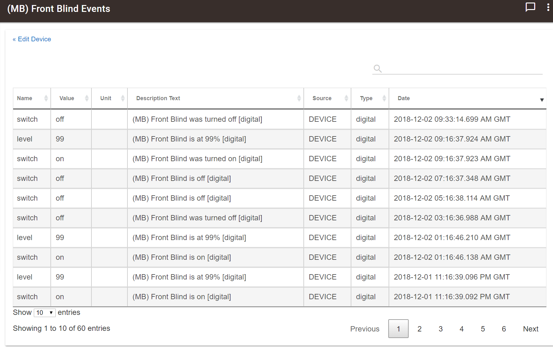

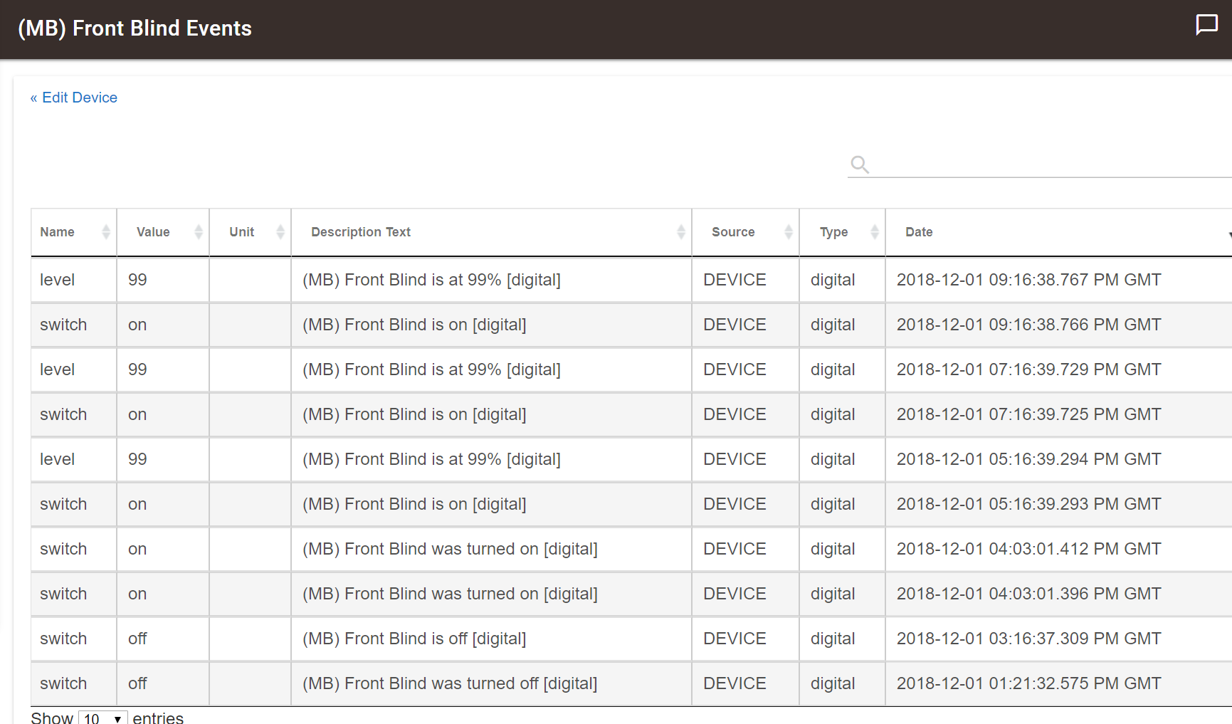

actually it doesn't work, not sure if its the driver but it keeps repeating commands and randomly opens them. @Cobra do you have anything like this in your events? There is only one trigger rule running and it should shut (turn ON) at sunset then open at 8:30 (turn OFF). If not then i will need to speak to Aeotec as there must be a issue.
the device is fine it was something funny on HE with the driver. I have used the new Qubino shutter module driver and that mostly works but it seems this device needs its own driver as it's a bit different to the rest (not best pleased with it if i'm honest) you manually have to give it a time for up and down but that's it! It doesn't seem to know 50 % so i'm assuming as it says it can, that this then need to be added in the driver. I've ported there ST driver but it throughs a lot of errors so there must be more need.
