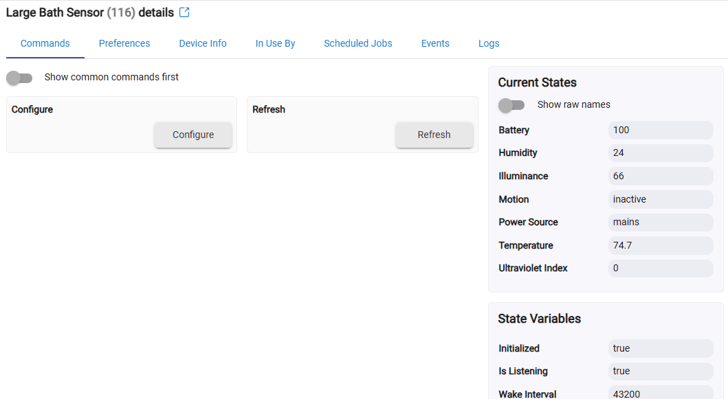

I used HPM to install the Basic Z-Wave Tool. The driver shows that it has been installed. I do not see any options to use it while looking at the Aeotec Multisensor. There are no additional buttons or drop downs anywhere as far as I can tell.
Interesting sidenote, there appeared to be two instances of the Basic Z-Wave Tool listed in HPM. I installed the top one and the driver matches the one I saw in your post.
What am I doing wrong? I have rebooted my hub, but alas nothing was there.
Again this is on my C8 that is up to date, and these devices are running on USB power.
The "Basic Z-Wave Tool" is a driver, so you change the device you want to work on to this driver, do your updates/changes, then switch the device back to its regular driver.
