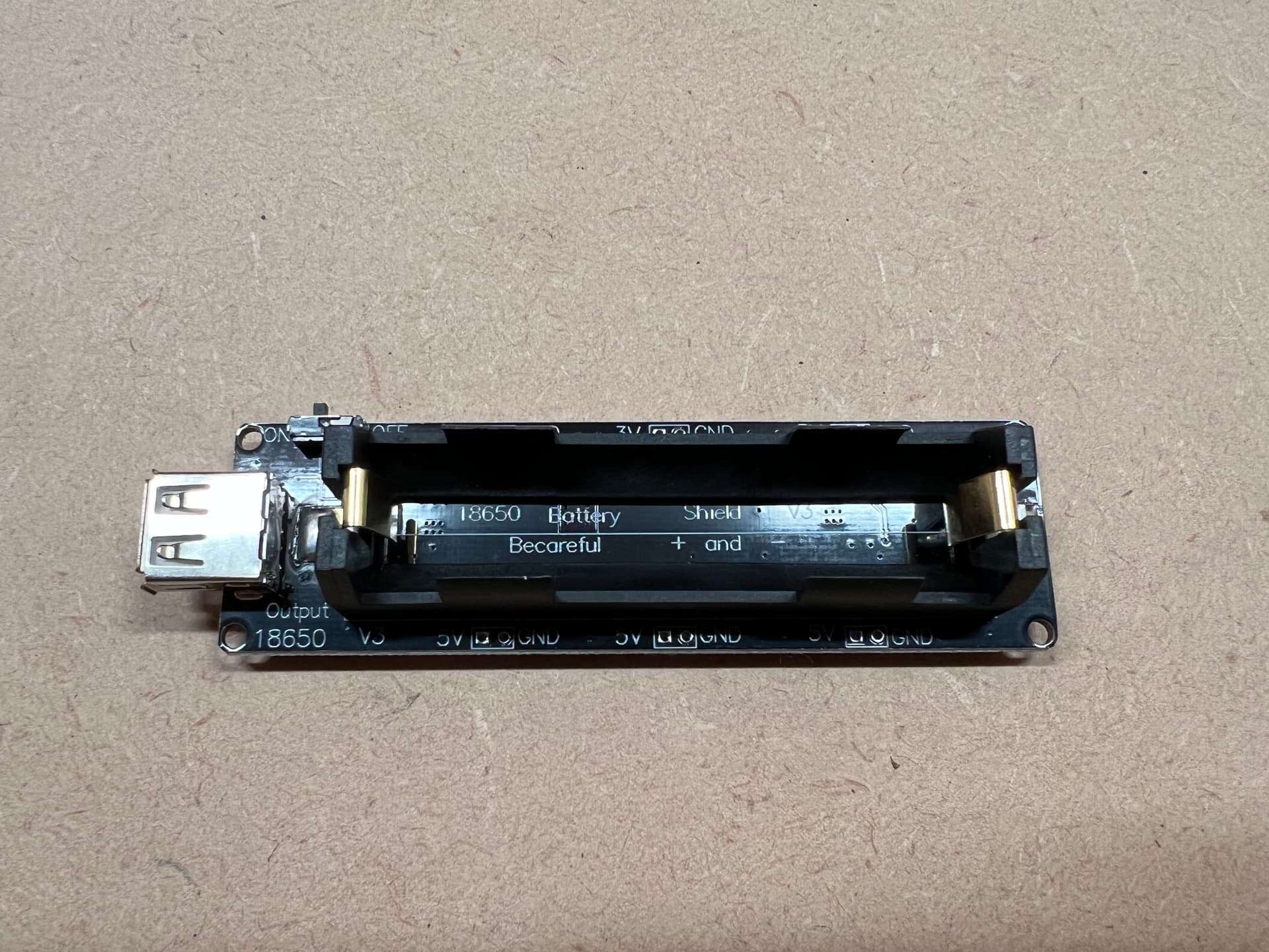

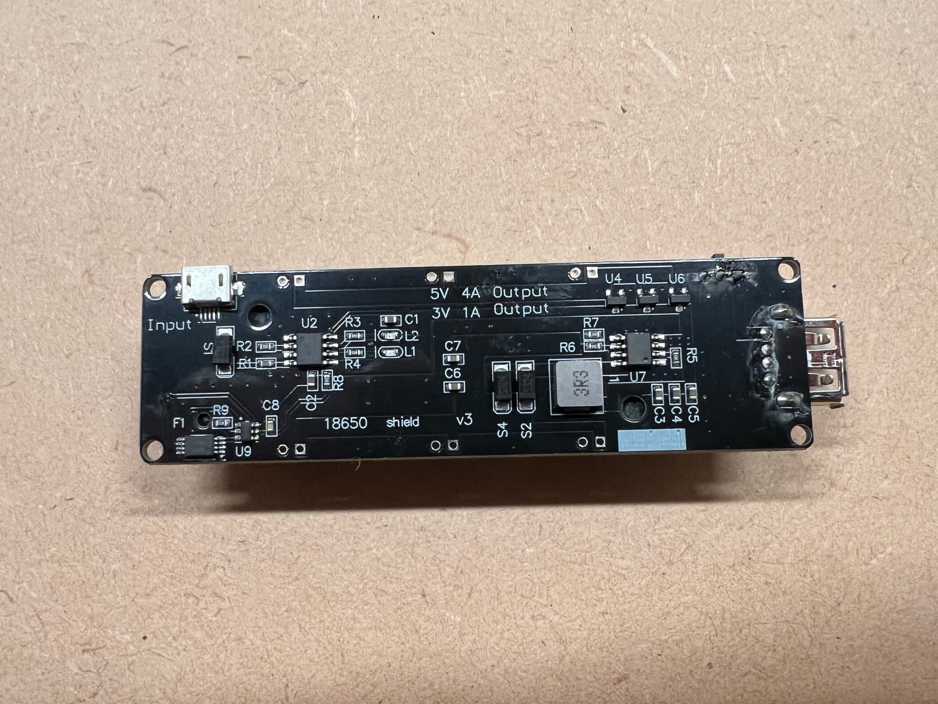

You can use a UPS as the battery source.. use the USB wire plugged into a UPS.
There are very small UPS available including:
Don't use a Power Bank battery to try it out... you cannot charge those AND power something at the same time, it requires a UPS like design. to do that.
Thanks! I went ahead and bought them!
