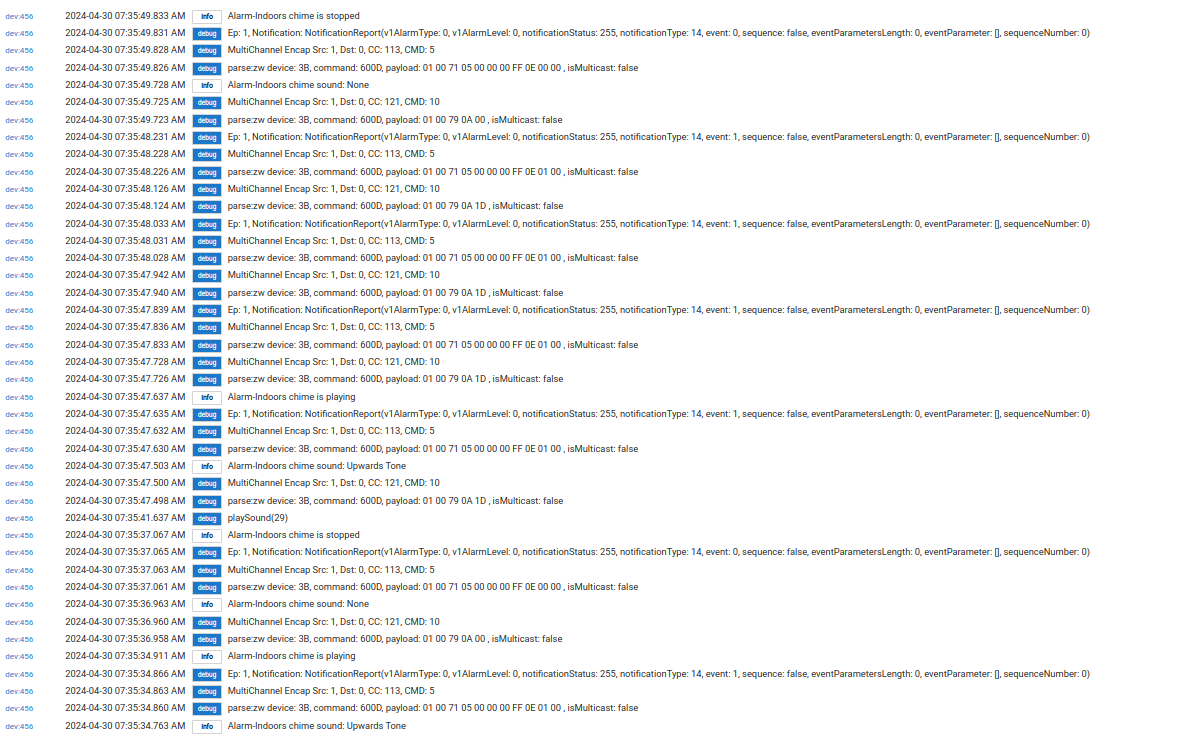

Uhg those debug logs are terrible, going to have to decipher them.
Was there anything else before that? Some normal logs? Or anything saying anything about supervision or retries?
That's everything based on the time when the event occurred.

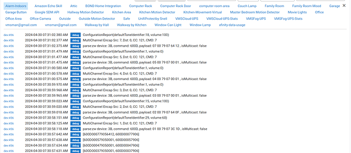

Ok that second one looks a little more useful. I will have to look at it more in depth to fully understand it.
If you want a quick solution, switching over to something like the Eco Link chime would be faster. It might take a bit of back and forth to get a basic driver figured out for this thing especially since I do not have one. I have thought about getting a chime though...
@bcopeland Any insight as to what is going on based on the debug logs above? Since I assume you made the driver you might be able to understand it a little better.
