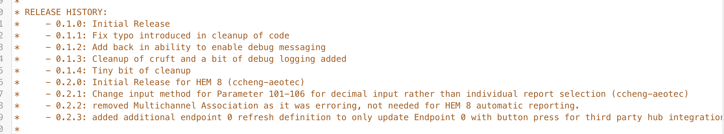

Quick question for velvetfoot. When you say you installed the latest driver, did you mean the updated version of the Aeotec driver, or was it Generic Z-Wave Dynamic Endpoint Device?
I see the Aeotec Driver has been updated since I last downloaded it with the following note:
" - 0.2.3: added additional endpoint 0 refresh definition to only update Endpoint 0 with button press for third party hub integration showing only endpoint 0"
As always thank you!
Aeotec. 0.2.3 is what I'm using.

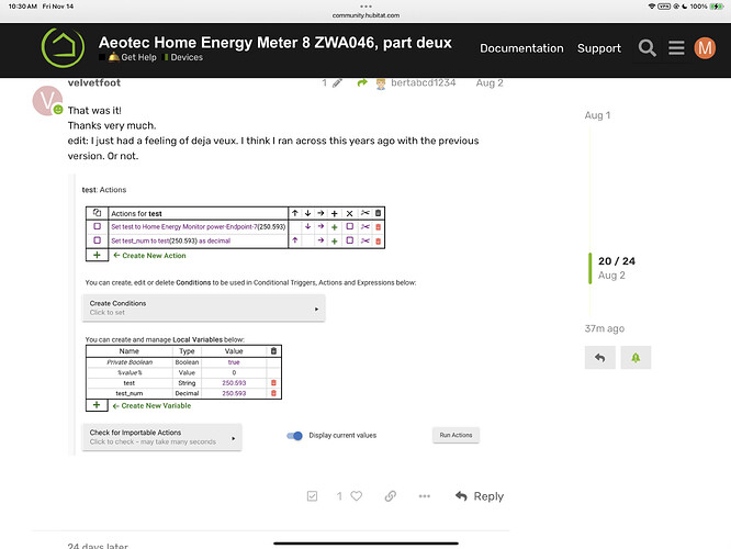

Thanks. Was it the attached? Cannot find anything else, and not quite sure I understand it. Thanks again!
Mike

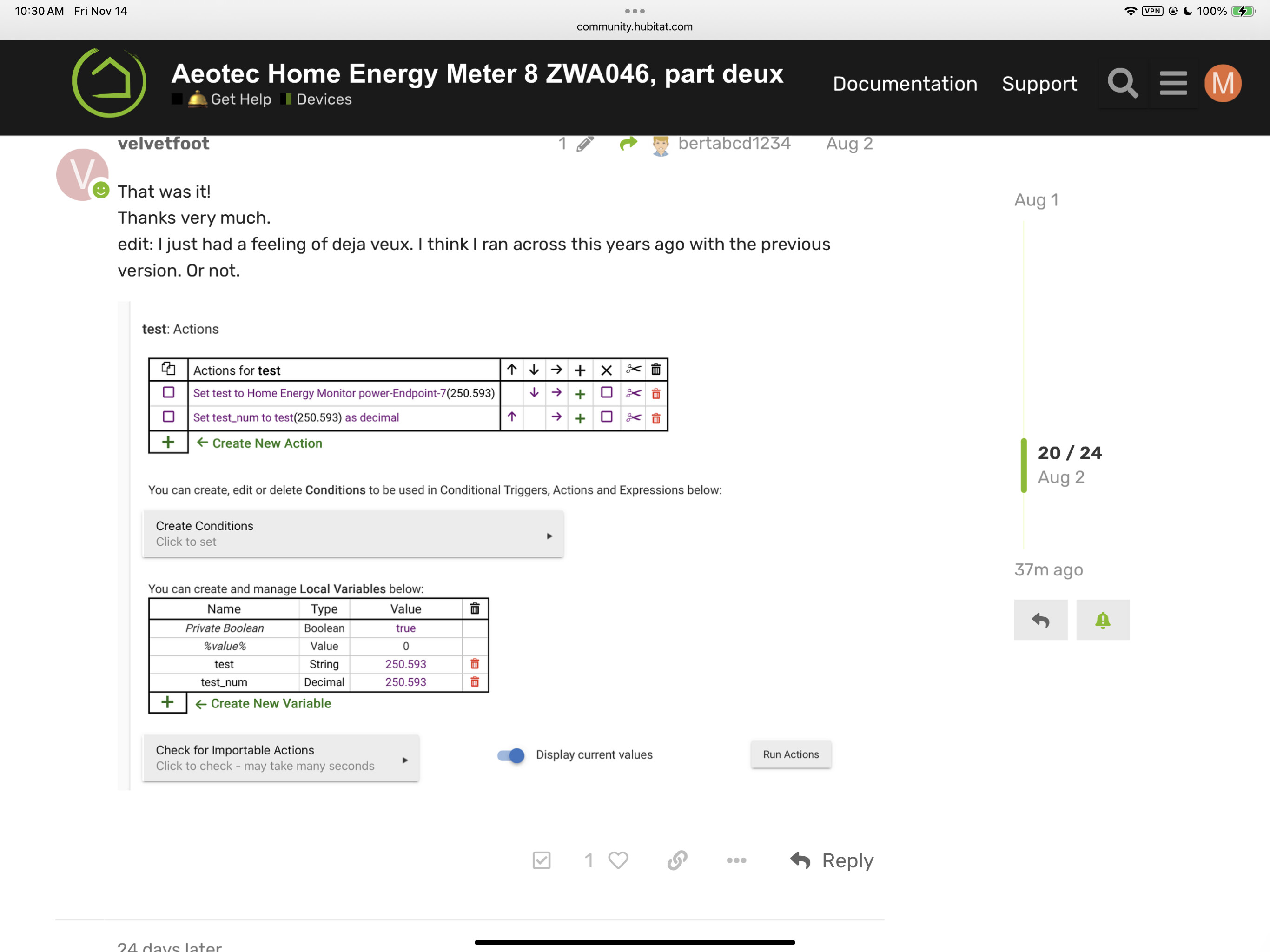

Create a numeric local variable in rule machine.
You can them assign as follows:
Set numeric_variable to numeric_string as decimal
And it will convert it.
Yes.
Thank you. If I understand correctly, in velvetfoot’s example, he gave a variable by the name of “test” the string value of Endpoint-7. Then he converted that to a decimal with the name “test_num.” Please let me know if I misunderstand.
So, one test_num is created, I assume it can be used as a decimal value for If Then statements, etc.
My other question is whether test_num can be used as a variable for a trigger in a separate rule?
Thanks again!
[quote="mike26, post:29, topic:155746"]
Thank you. If I understand correctly, in velvetfoot’s example, he gave a variable by the name of “test” the string value of Endpoint-7. Then he converted that to a decimal with the name “test_num.” Please let me know if I misunderstand.Correct
So, one test_num is created, I assume it can be used as a decimal value for If Then statements, etc. Correct
My other question is whether test_num can be used as a variable for a trigger in a separate rule? I am pretty sure that is false. I think only hub variables and private Boolean can be used that way.
Also, I don’t think the test variable was needed. He could have assigned the value directly into test_num if he added as decimal to the statement.
