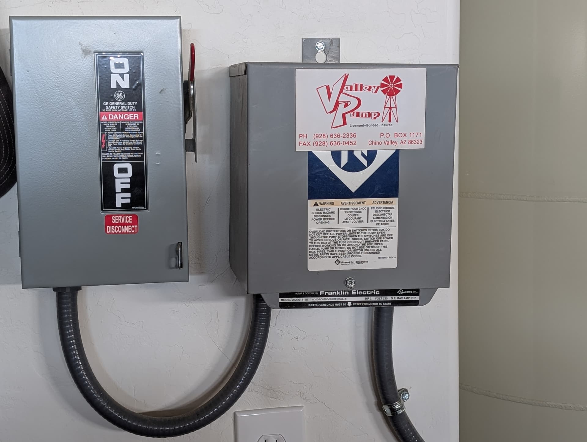

I want to add a switch to control my 2 HP 240 VAC submersible water pump. I have an easy place to install it just after the 25-amp-fused disconnect in the garage.

The Aeotec unit has input on right, output on left. That is reversed from what would work more naturally in my installation between the disconnect and the pump control:
But in reality I can make either unit fit, and either unit will be pretty easy to install.
