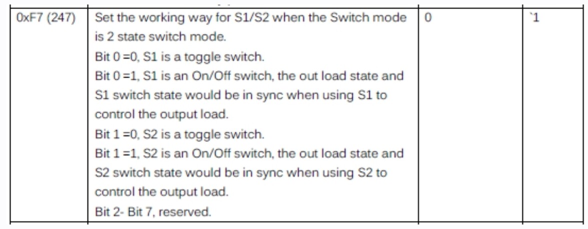

If anyone else comes across this, i could see this in the manual so i reached out to aeotec support..and they provided the solution.
Just set:
Parameter 247 [1 byte] = 3
This will set both S1 to only perform in-sync controls of OUT1 and S2 to perform in-sync controls of OUT2.
