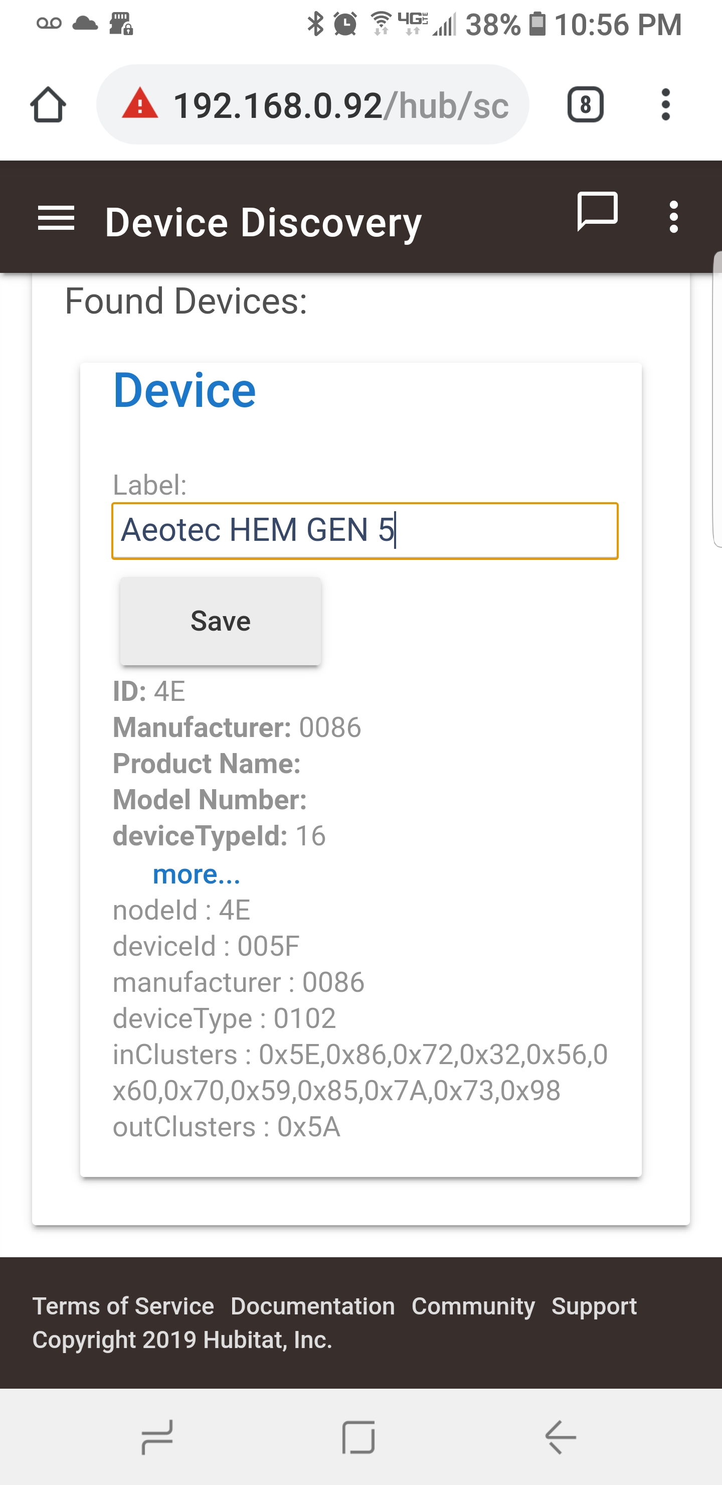

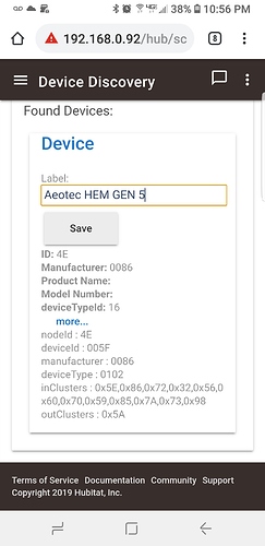

Second aeotec device in 2 days that only pairs as "device" . I love their stuff, the Z-wave is so solid and devices are very well made.
Just installed the HEM5 energy monitor, gen 5 and it only paired as "device". I switched the driver to Aeon energy monitor but I'm only seeing one reading that says energy.
Here's the fingerprint:
I haven’t been able to get the HEM5 to pair and give proper readings. All my readings are of a negative value. Doesn’t matter which way my camps are aligned.
