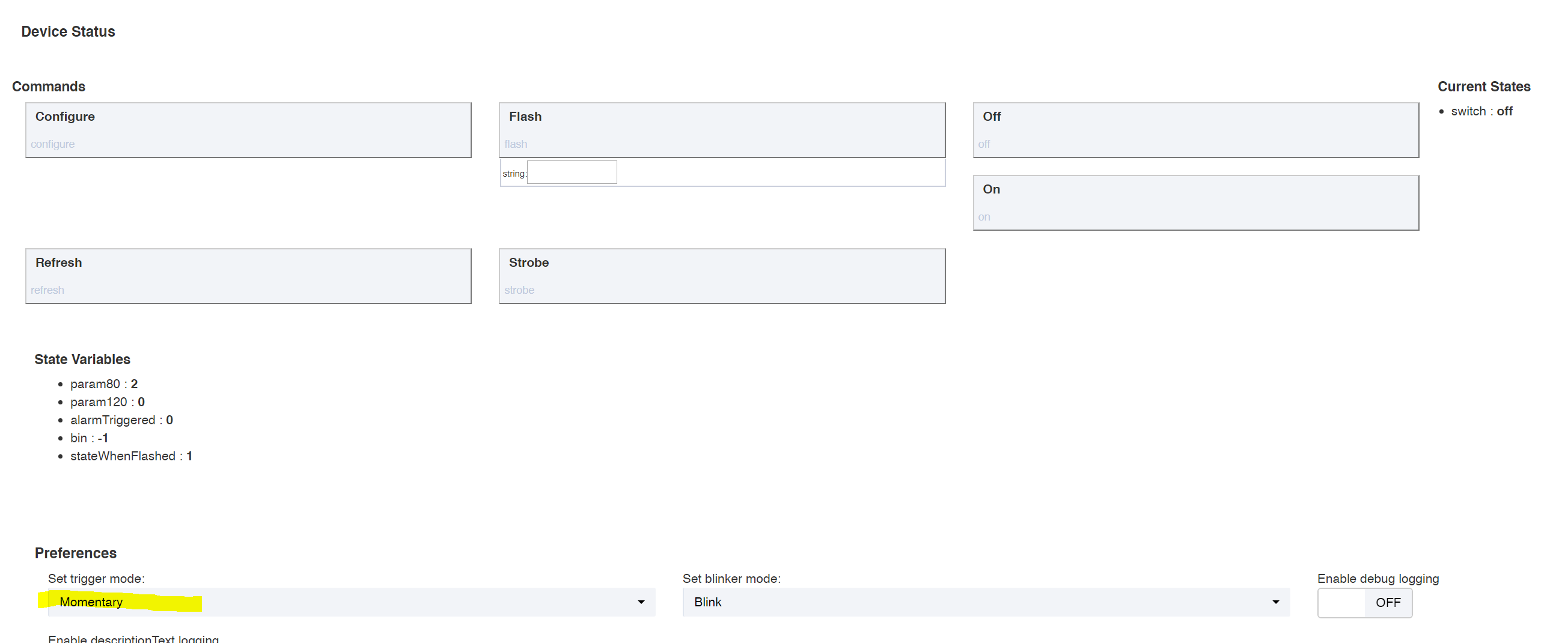

Apparently setting trigger mode for Aeon Micro switch is not working anymore. I think this is happen after recent hub firmware update.

trigger mode for the physical switch connected to aeon micro. Param - 120

I have 3. Two of them won't change settings from the driver, but I was able to change param 120 using your basic z-wave tool. Third work fine from the driver.
