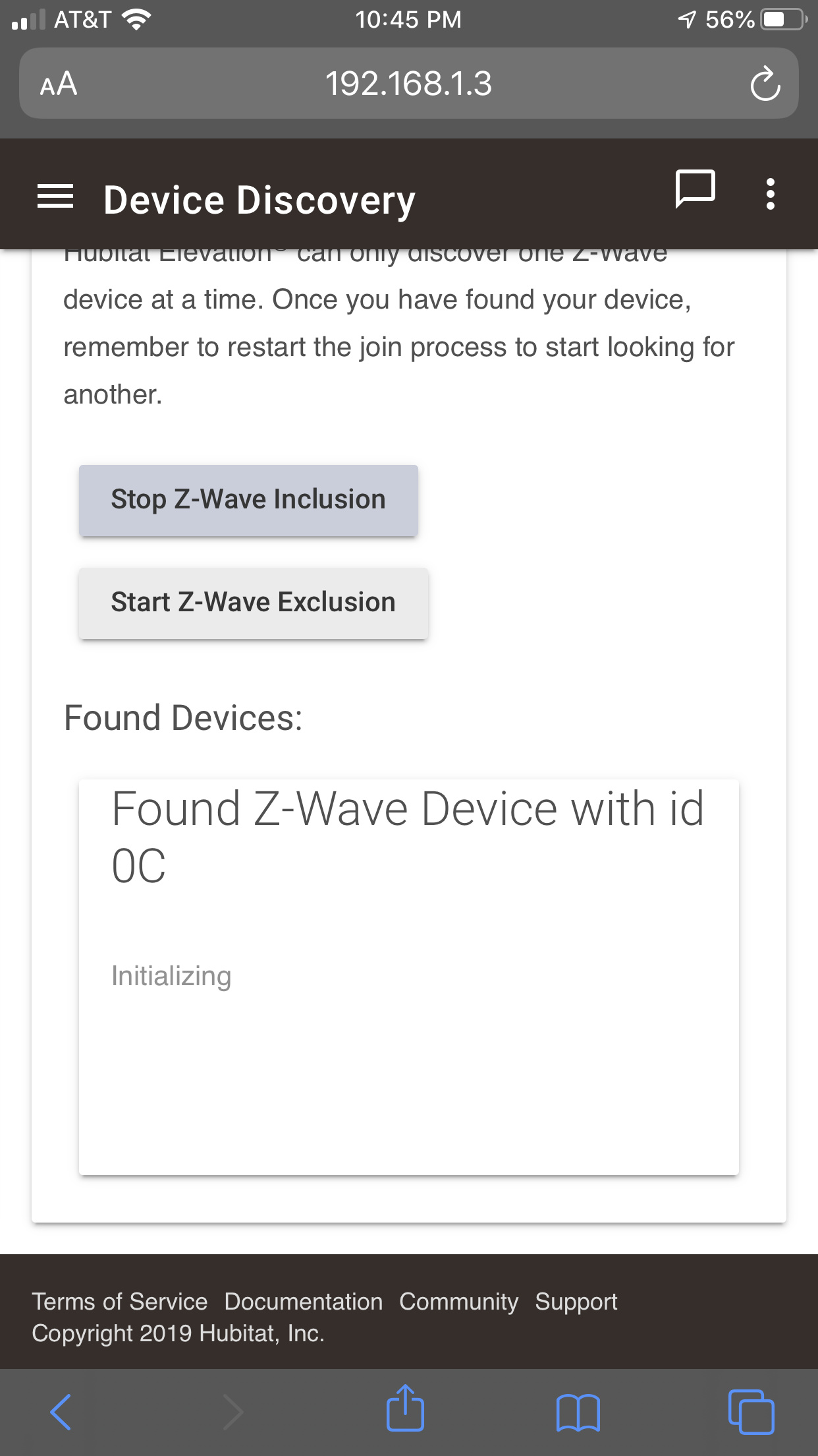

I have migrated everything from my Wink 2 hub except the water sensor I used for monitoring my basement sump pump. I put the sensor in discovery mode and the Hubitat Elevation hub will see it, but it will not go past this step.
I have added a picture of what it looks like when it hangs up. I did a search of the forums but did not see anyone with this issue. What could I be doing wrong in this case?

Try this -
  1. Exclude the sensor
  2. Reboot the hub
  3. Include the sensor
Seems as if rebooting the hub fixed it. I had excluded and factory reset the sensor and tried to include. Adding the hub reboot fixed it. Thanks @aaiyar!
