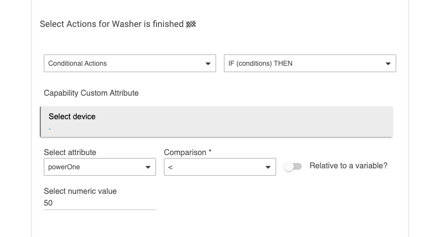

Use Rule Machine custom attributes. For reasons that have nothing to do with this, one of my three Aeon v1 HEMs is named "." so just ignore that and imagine it's named Aeon HEM.
So just create a rule for each clamp. Install one of the clamps around the Hot wire for your washer breaker. Install the second clamp on one of the Hot wires from your dryer. You'll have to try each of the two on the dryer. One will read higher and will give more stable readings. That's the correct one.

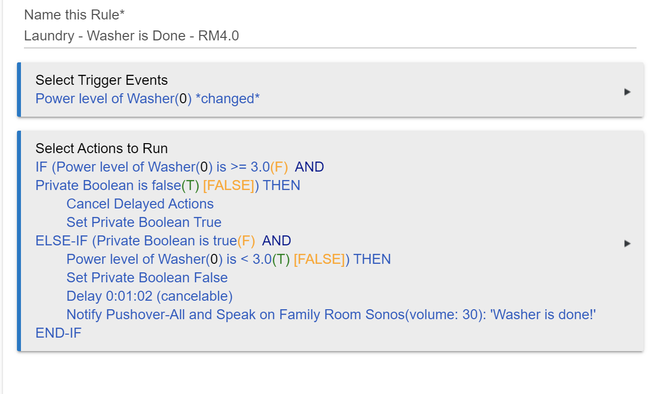

Here's an example for the washer. Your HEM driver needs to show readings for each clamp separately. All three of my HEMs are v1 and use a custom driver. Don't know about the v5 and what driver needs to be used.
The action will be whatever you want. You'll want to add cancellable delays to the action, so if your washing machine pauses, you won't get false notifications.
Here is one of my two 'laundry' rules. They work great once you dial in the power levels for your machines...
