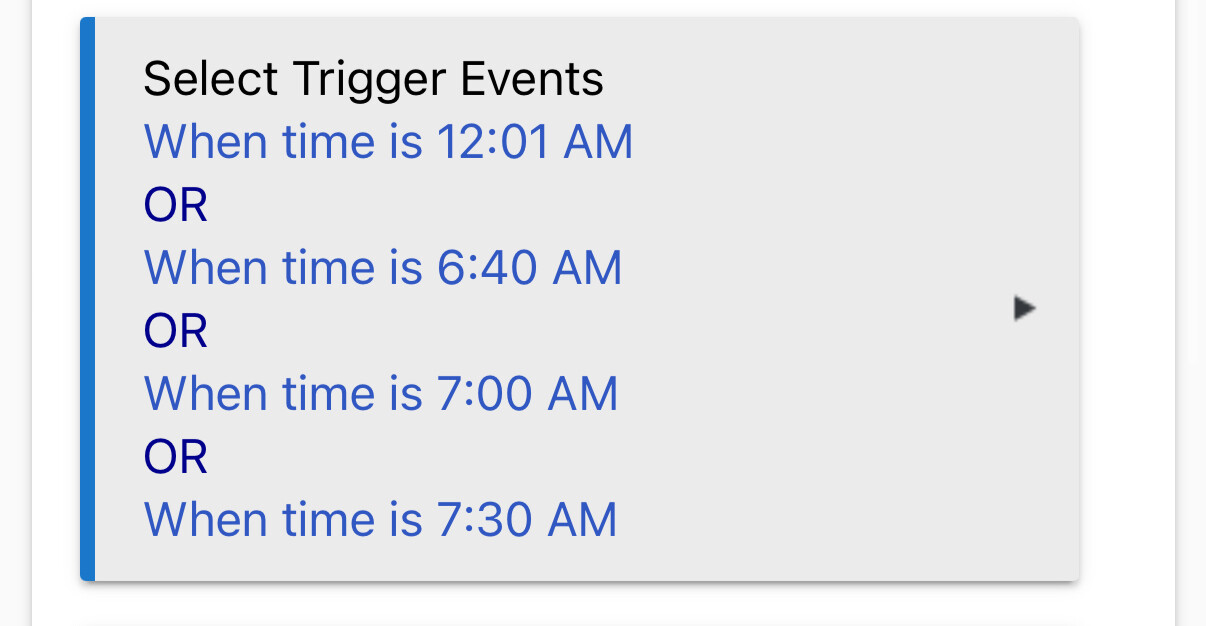

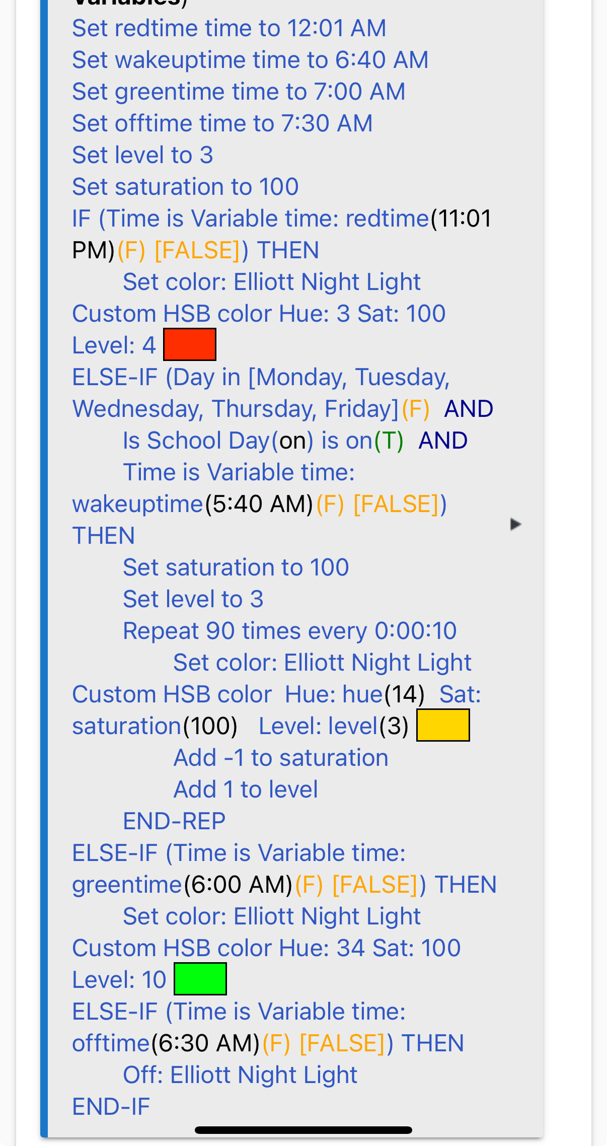

I don’t have any advice offhand, but here’s what I’ve been using for my son.
  1. Yes you can create a hub variable with time and just use that to trigger your rule.
Trigger at a certain time. I do this for a rule I use to heat my bathroom in winter. I have the variable on a dashboard and I change it as needed.
2, There should be a stop command for a level change. So I would think you can send a stop level change and then off. I am not really sure as I have never really done this, so perhaps someone else can give you better advice.
  1. I have a third reality button by my bed. If I push the button it runs my normal goodnight routine. If I hold it, it runs the good night routine and enables the heating routine. If I double press the button it activates the bathroom heat immediately, in case I wasn't sure when I would get up.
With RM you can have a great deal of flexibility. I have been meaning to adjust the button to different things based on time of day and time of year. Just haven't got around to it yet.
