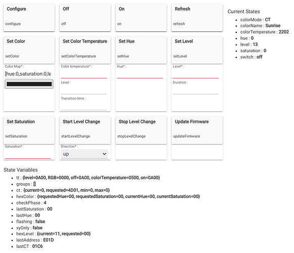

This is the driver automatically selected when I added a Gledopto GL-C-007 controller

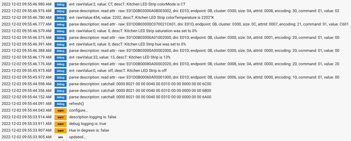

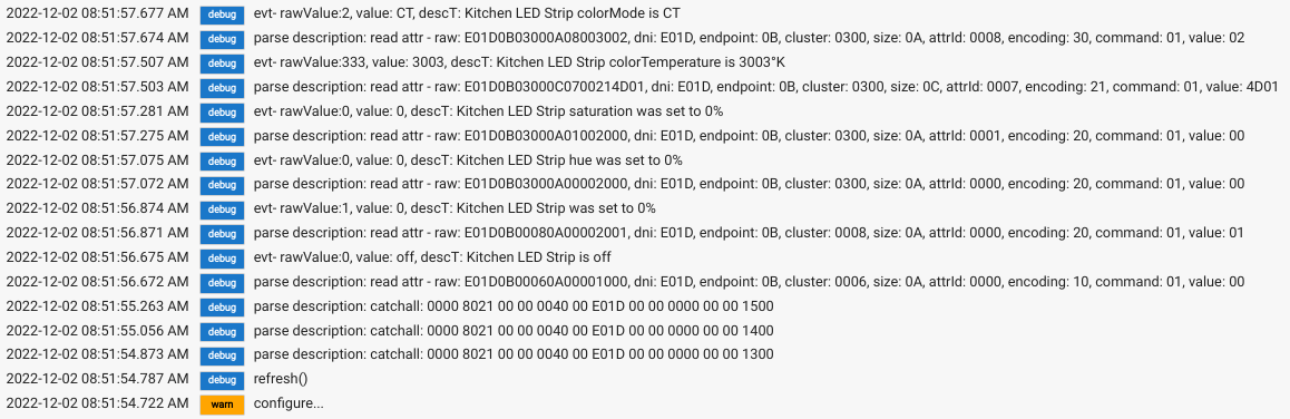

When I click on Configure the log shows this
And I suspect it has something to do with why the controller is not behaving as expected. This same device worked perfectly when connected to Zigbee2MQTT so I do not suspect it's bad.

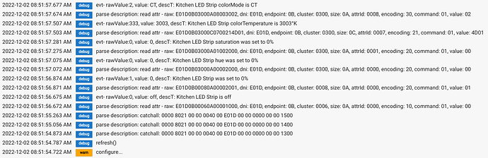

Even On doesn't work reliably and the log has this

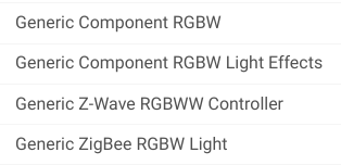

I tried these other drivers but they don't work at all
Wish I could help, but I am not familiar with that particular device.
I can tell you that any driver that starts with “Generic Component …” is actually designed to only be used as a child driver. Those drivers cannot be directly used for any device that communicates via Zigbee or Z-Wave. Their Parent device is what would have to handle that type of communications. This, no need to try the Generic Component drivers.
Have you tried "Generic Zigbee RGBW Light"? I see you listed it, but did you get any errors or have any other problems with it?
I don't see this one on the list of compatible devices, but the only other Gledopto model suggests this driver. The "Advanced" one won't work with all devices, and the error during configuration may be because this is one of them.

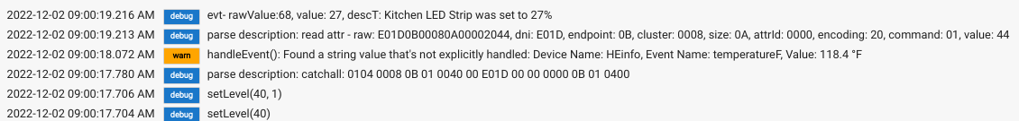

Just a couple of things in the log that you may want to look into, @mike.maxwell

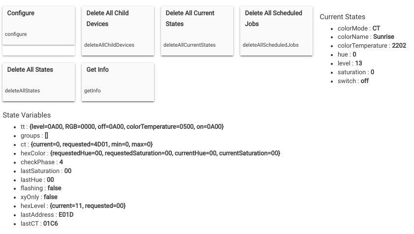

Not sure this is helpful but going back to the right driver...
It never responded, oh well...
