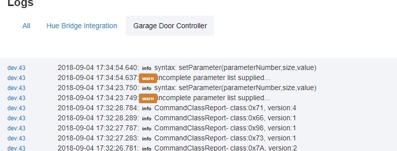

Soooo had some developments, no idea why but was just randomly clicking and now clicking the "Set Parameter" button gives this off in the logs
However I put in the parameters I want to set and still no go What I am putting in is:
NUMBER: 37
NUMBER:4
NUMBER: 16843008
I get those warn errors even if I have data in the first 2 inputs but then when I put the final value in for 3rd one then nothing.
@coops8d, correct me if I'm wrong but the value you have for the last number wont be accepted by the Aeotec device. you have 16843008. As per below link the first two digits can only be from 01-10, the second two I think can only be 01-04, third two 01-10 and the last two 01 or 02.
Did I read this wrong?
Could be wrong? But I am going off this pages instructions Disable Alarm Sound in the Garage Door Controller : Aeotec by Aeon Labs
From this part
"I would suggest setting this value to parameters 37 - 40 [4 byte]:
0x01010100 hexidecimal or 16843008 decimal"
