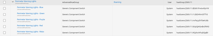

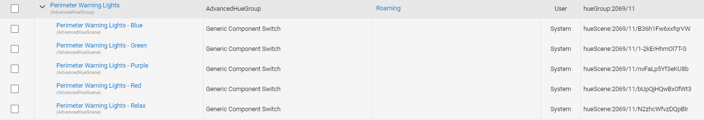

Thanks for your response - I do not use HE scenes, but I do trigger Hue Scenes via child devices as per the below parent / child screenshot in use cases demonstrated in the below rule.

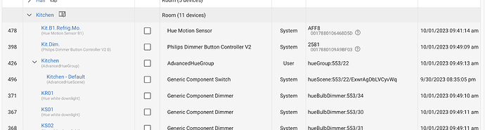

As I related earlier, I originally had not used Hue scenes at all - now I'm coming up with ways I might utilize 'em. So I've added one scene to a couple of rooms at the moment, but I can't progress because. . . my OCD.
When I view the Rooms in HE, the last scene created is duplicated in the list. Fair enough, but it's not the same for scenes in other rooms. I deleted the duplicate which deletes the single scene device, deleted the Group (room) parent, and reinstalled - but the child is again duplicated (only as witnessed in the Room display in HE).
Is there a reason I should see that duplication of the Cafe-Default device in the Room list of devices, or ???
