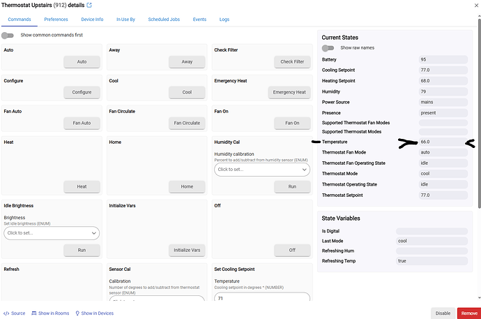

I am using the bcopeland Advanced Honeywell T6 Pro Thermostat driver and the room temp has been stuck on 66 in the app. (See screen snip)
The Tstat is working fine as it should room temps have been around mid 70's and we manually turn on the AC at night to say 73 and everything works as it should. i am just wondering how I will setup any automations when A/C season sets in.
Has anyone seen this issue before or have any ideas how to remedy the issue? TIA
I've had that issue once or twice. Simply removing it from it's base (remove batteries if you have those too) and putting it back on to power cycle it "usually" gets it back to where it's supposed to be.
