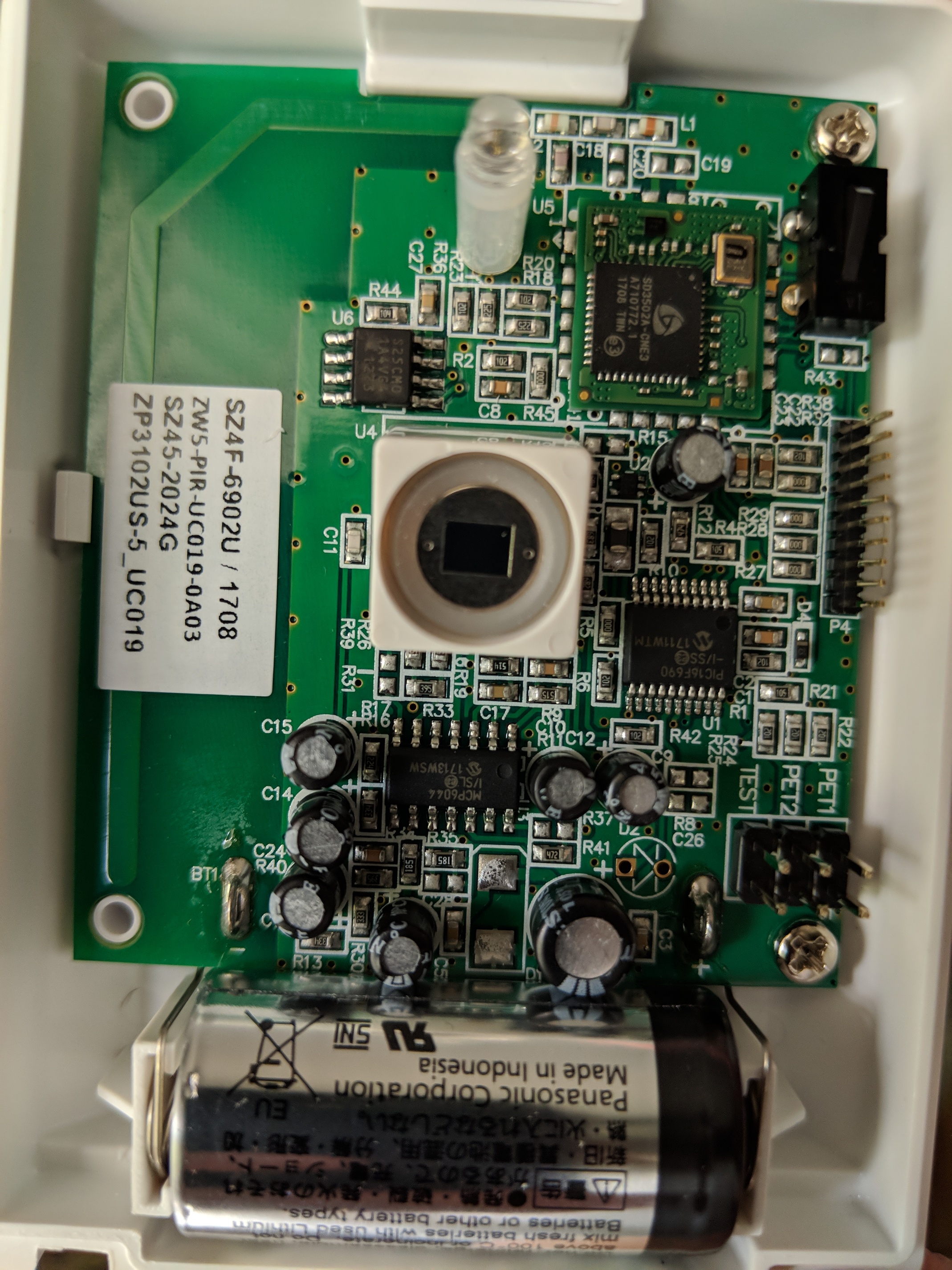

Is this one of the monoprice unbranded sensors that uses physical jumpers to adjust the sensitivity?
yeah, you'll need to do that as we're unable to find these parameter settings.
Manual.. did my best to scan it :slight_smile:
https://drive.google.com/file/d/1kYl8H-HkcG99pIc0xajHvWnSmeBSdik9/view?usp=sharing
image of inside..
thanks!
