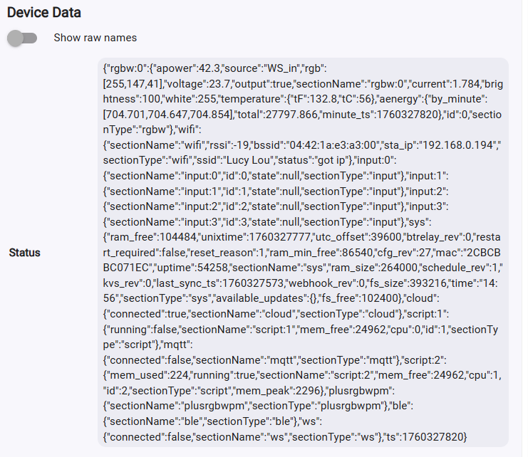

Hi @bobbyD, The community drivers and the old way of adding using the virtual switches used to create a parent / child set of devices with the parent being the device inputs and the child being the relay or light output control, Ive added a Shelly WiFi v2 RGBW Light and its fantastic that I can control the device and it updates its states promptly, however I am unsure of where the i1 - i4 inputs are? Are they not exposed with this integration or am I missing something dumb? I can see them in the device data but not in the commands nor are they available as buttons in rule machine, see attached image,
cheers

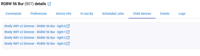

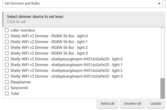

Hi Duncan,
the RGBW2 has only 1 switch input, for the 4 channels. the RGBWplus has 4 switch inputs.
With the classic RGBW driver, the RGBW2 module has only 1 control.
But using the "integration" app, for the same module I get a parent and 4 child devices, and in the Rule Machine I can select the child/channel

Hi Marc,
I can see the output controls, just not the input controls. When you try to create a rule, or push a button, there was no interface for those devices. It used to be that the parent device handled the inputs and the child devices were the output channels.
Cheers
Duncan
Hi Duncan,
you're right, there's no way to acces the inputs. you cannot use the RGBW2plus as a button device. you'll have to use one of the shelly I4 versions
cheers,
Marc
