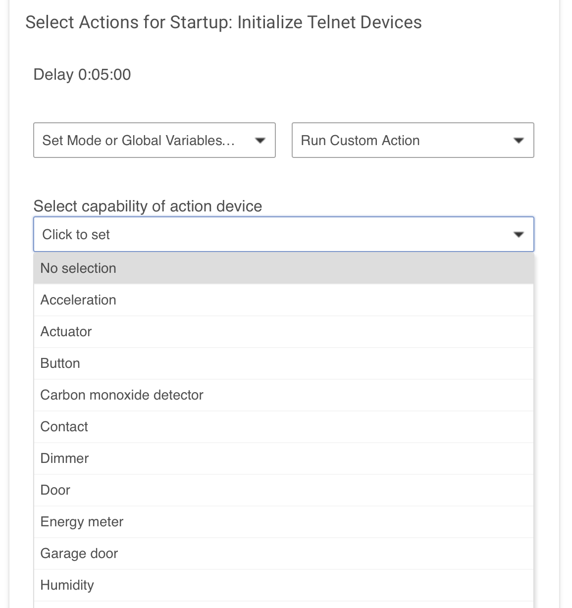

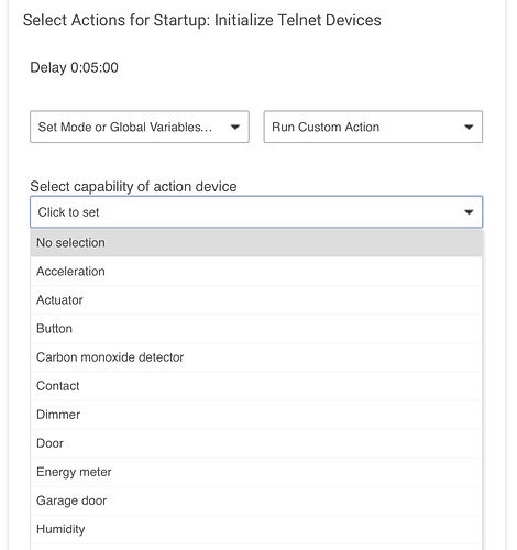

Add Telnet to RM Capability Action List
@bravenel could you please consider adding the telnet capability to the RM “select capability of action device” list? When hub restarts I would like to run a rule to initialize a few Telnet connections that my hub has with LAN devices. One in particular is my for my UPS that is connected to my NAS and that driver doesn’t have any capabilities from that selection list so I am having to add an extra unnecessary capability just to select in a custom action. It would be awesome if Telnet was in the list.
Thank you for your consideration!
