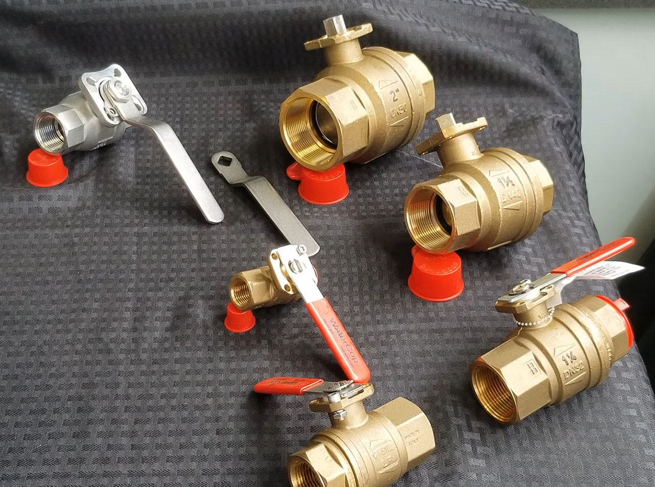

It should be possible by removing the Watercopy actuator and putting on a rough-in valve such as shown in the image below. Mine didn’t come with a rough-in valve, so part of this is finding out whether some stock handle will fit it.

I mean if you can find a lever that fits the Watercop valve, that’s all you would need to switch. That would alleviate the need to cut anything out.
Exactly. It should work, but there may be some gotchas. The ball valve handle needs to have the right hole to fit over the valve, and I’m not seeing any that look exactly like the ones in the photo. Also, the replacement handle will sit tight with the valve square, which may be unlike a typical ball valve which may not provide enough clearance.
