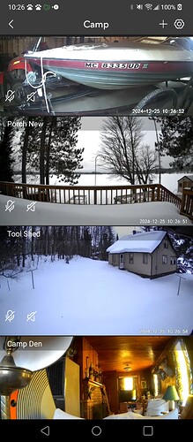

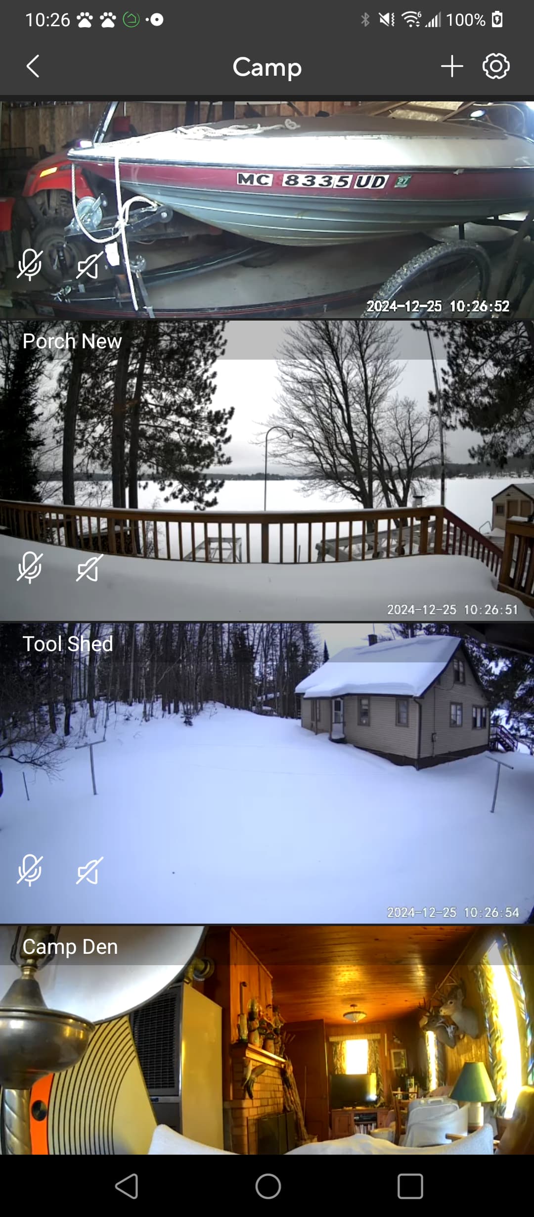

not true.. i have cg nat with starlink at one location there are a few things you can do.
i have 3 ways to access my devices.,. and main router is an asus gt11000 pro running merlin,
  1. put a cheap gl-inet router behind it running tailscale.. they have their own ddns and you can then reach your whole network.,
  2. run a point to point vpn on the asus.. i use openvpn to one of my other locations and with correct setup can reach my network behind cgnat,
  3. look at localhost.run with some wizardry you can setup an always up reverse ssl link so that the router is reachable outside the cgnat environment.
i also schedule the router to reboot once a week.. presumeably so at worse case i am only down a week at most.. In addition i have kasa wifi switches and one on the main router using the wifi on the backup router so hopefully if need be i can reboot that remotely as well.
so far for two years on starlink with cgnat i have only been down a few hours at most..
other than starlinks own outages..
ie
assuming you get an asus router that runs merlin or a glinet router i can assist with any of those setups.. I spent some time and research getting remote access to my starlink reliable
