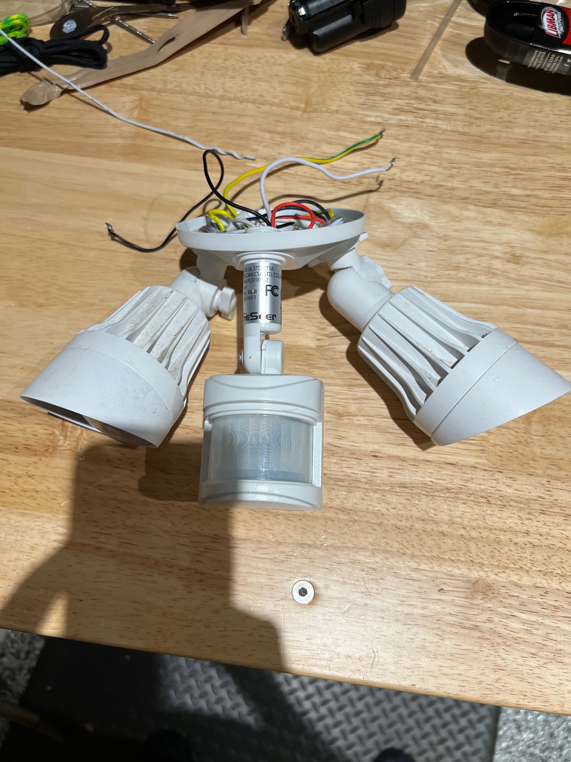

I’ve got one rigged up to a LED floodlight that I am no longer using. I recently replaced this floodlight with a Ring floodlight camera. Willing to sell and ship it to you if interested. Works greats just don’t need it any longer. PM me if interested.

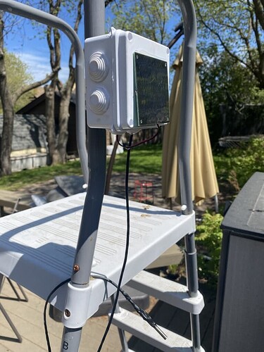

I use a bunch of these sensors to manage my pool solar, and as of the weekend, am also tracking ERV efficiency with them. Link below is to my "live" data feed.
