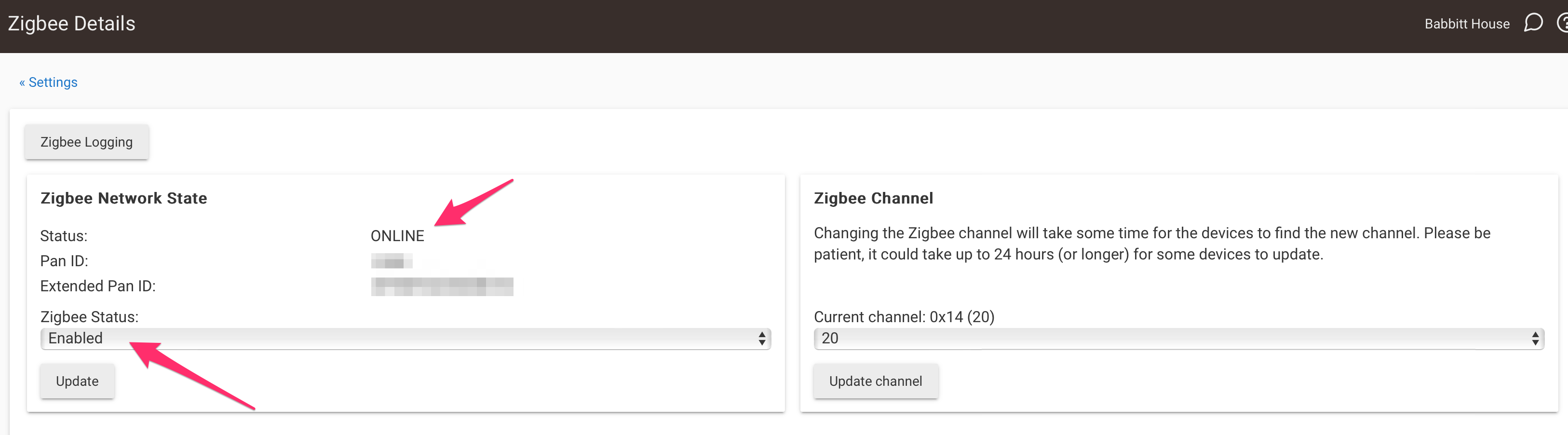

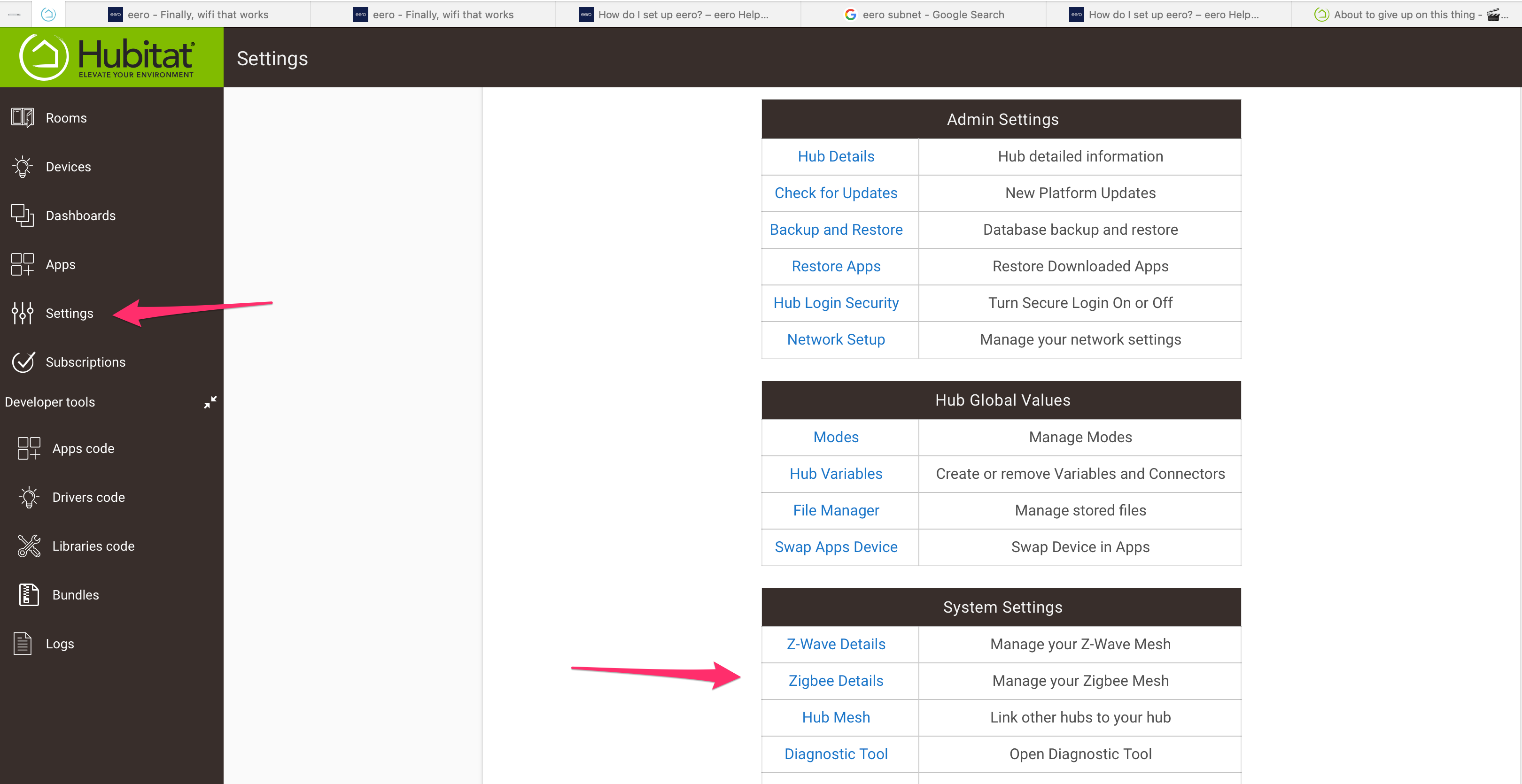

  2. Have you confirmed that the zigbee radio on the hub is running?

Please check the notification in the upper right corner. I sent you a private message.
Hello, I have confirmed factory reset for all bulbs (I've tried 2 Cree and 3 Sylvania bulbs thus far). I'm not sure how to confirm the Zigbee radio is running. Can you tell me how that is done? Thank you very much
