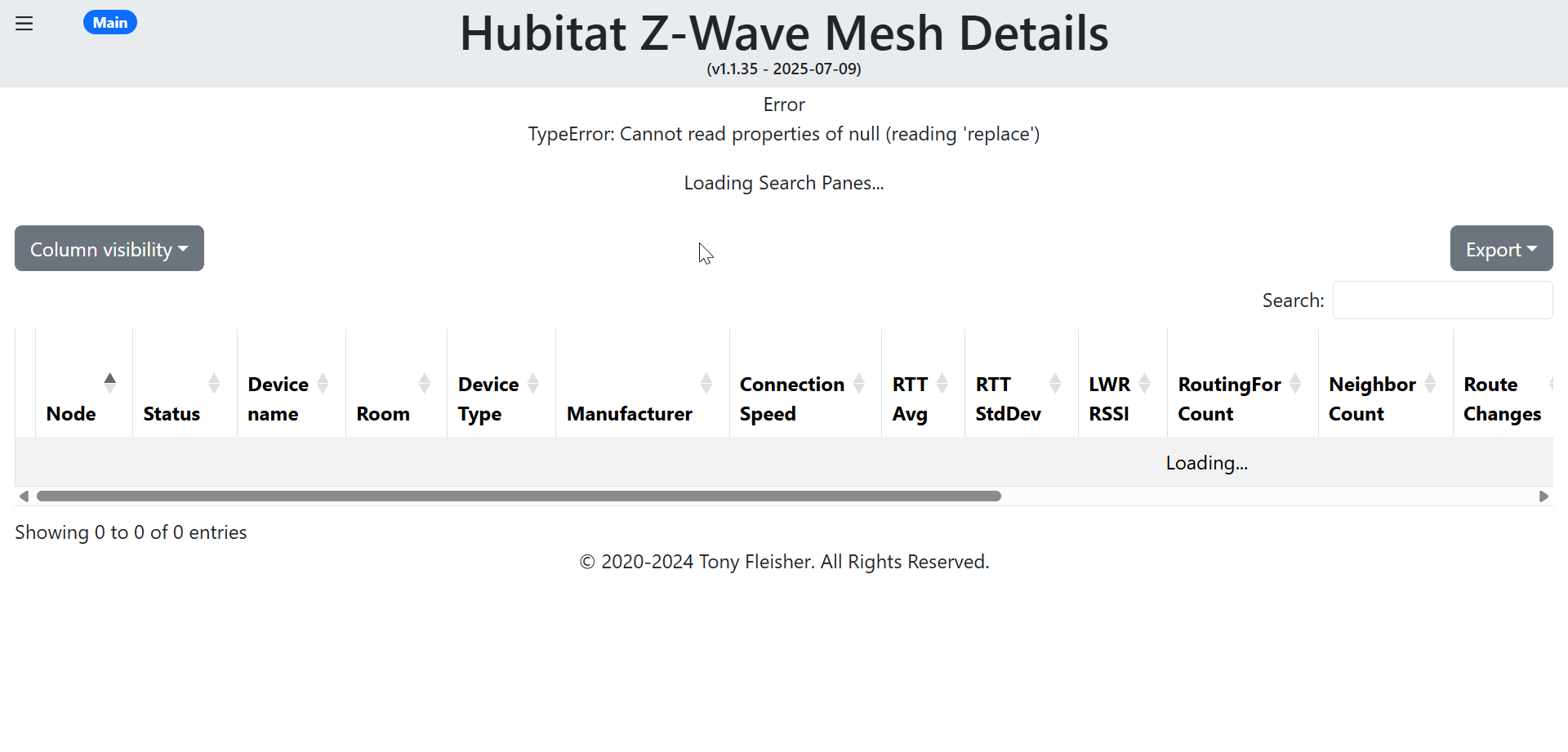

I'm getting an error when I run your app. I've re-installed it, reset settings, enabled debug logging and cannot figure out what is wrong.
Here is the error shown and the only thing listed in the logs.

Is your hub using ZWaveJS or Legacy?
Legacy...Zip
I figured this issue out and leaving the results for anyone who might experience the same thing...
I was looking at my Z-Wave devices and the error I was seeing when opening this app. The error said "Cannot read properties of null".
On my Z-Wave device list, I noticed I had two outlets that were missing the "device class" info. These are devices that were originally included in 2019, so I'm not sure when or how that info got lost, but it was missing on those two devices. I even tried to mess around with the Device Note app to fix it, but that didn't work...
I removed and re-paired the two outlets and they now show up as "SPECIFIC_TYPE POWER_SWITCH_BINARY" like the others...
After all this, I fired up the Z-Wave Mesh Tool and it worked perfectly like before...
Somehow that data on those two devices got lost maybe during a hub update or when I was moving back and forth between JS and ZIP last year?
Anyway, hope this helps someone else!
