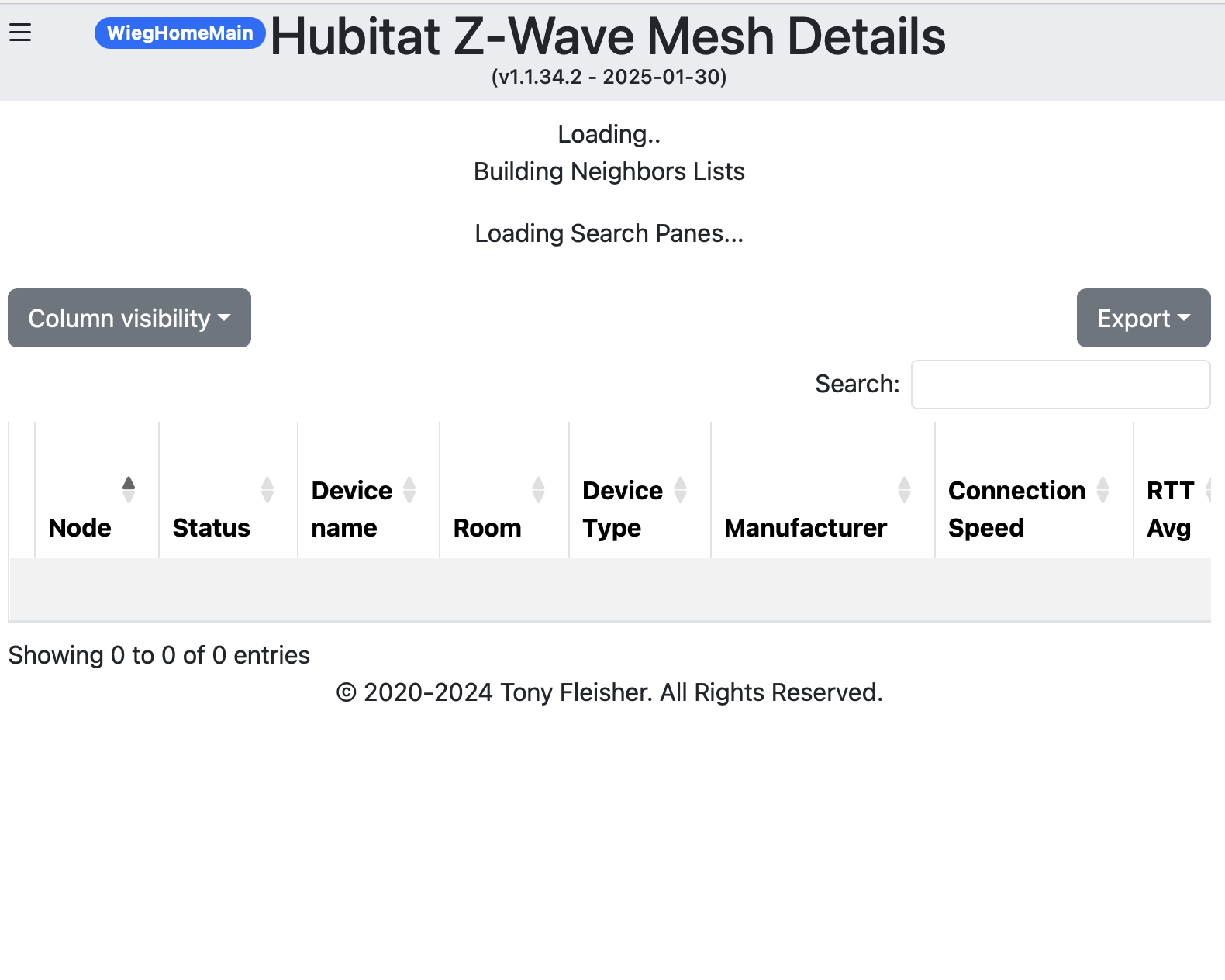

Hey Tony, I've got the new version 1.1.34.2 (2025-01-30) loaded on 4 hubs. For reasons that I cannot get my arms around, it works on 1 hub, but doesn't on the other 3. All 4 hubs have login security enabled, and all have HTTPS enabled with similar certificates. I've tried resetting, etc. I've tried multiple browsers, with HTTPS and HTTP only. I haven't had time to dig into the code though.

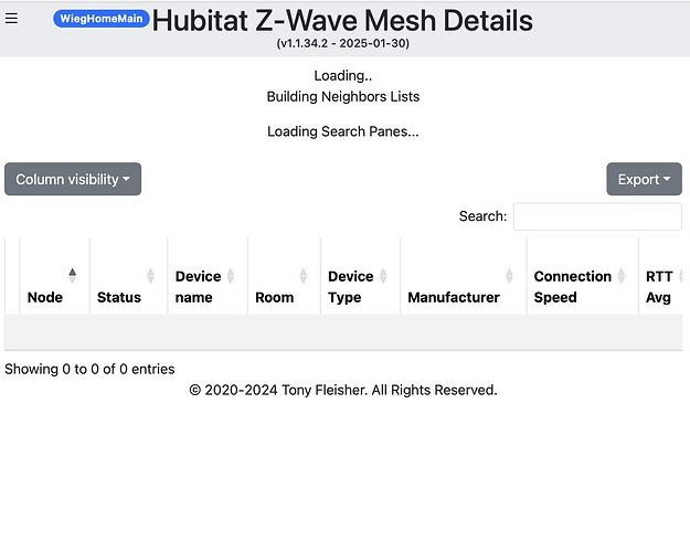

The ones that fail all look like this:
Any quick thoughts? TIA.
What browser are you using? This is Chrome on the iPad
Safari and Chrome on macOS are both working normally for me too.
@dennypage This isn't one that I have seen before. Is there anything in the logs?
If you can open developer tools and PM me a screenshot of the javascript console, i could probably narrow it down.
Thx Tony. Nothing in the logs. I’ll see about getting JavaScript console.

Is this working for anyone after updating to ZwaveJS? I'm on a C-8 Pro running 2.4.1.154 and the Mesh Tool never populates. Just hangs:
No - I don’t think it has been updated to support ZwaveJS yet.
Thanks for the confirmation.
HPM just downloaded an update. Version 1.1.35. It is now running on my C-8 Pro with ZwaveJS. Thank you @tony.fleisher

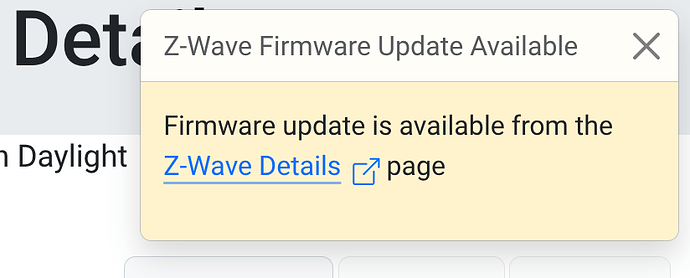

I just installed this to see if I could get a ghost node removed. When I launch it, it says I have a Z-Wave Firmware Update. When I click the link to go to my Z-Wave Details Page, there is NO button to update the firmware. What am I missing?

As for the firmware update notice, can you provide more details on what you are seeing? A screenshot of the top of the left sidebar/menu (click the 3-lines icon to open), which should show platform version and zwave version info would help.

I'm seeing the firmware notification after updating to the latest Hubitat OS version and changing to ZWaveJS on a C-8 Pro but the update button is not shown on the Zwave settings screen.
"Firmware update is available"

That's not what that button label means-- it's basically a "Save" button for the only setting you can change, the region setting right above this button. See: Z-Wave Details | Hubitat Documentation
If you're also asking about the "firmware update is available" message, that is coming from this app, not your hub. It's probably just confused by the fact that 7.22 was available for a bit but pulled due to some backup/restore issues. Firmware 7.18 is considered current at the moment.
