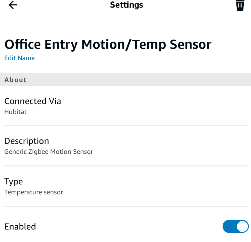

I have been integrating using the HE provided Amazon Echo Skill. Recently, improvements on the Amazon side allow me to add sensors.
Putting motion, temp, humidity, and contact sensors allows me to have simple rules on the Amazon side and this has been great.
A problem exists which I believe is a foundational issue on both sides. Multi-sensors. It is very common that sensors have Temp and Humidity or Motion and Temp.
Using the Generic Zigbee Motion Sensor driver, also provided by HE is not useful. It comes over to Amazon as a Temp sensor, and the Motion sensing is not visible. Amazon knows this, and says it exposes the motion sensor separately.

What sensors are you using? I have Iris v2 devices using the generic zigbee motion driver and mine are showing correctly in Alexa. I use them for routines triggered by motion and can ask her the temp of the devices.
heading to the office but quick reply - its an aoetec motion/temp sensor. Now that you asked, I'm concerned it isn't actually a temp capable sensor at all.
Have you tried setting the “default current state” to the motion attribute in the Hubitat device’s preference page?
Tried that - honestly I didn't expect anything as that value I understood to be related to the new gui on hE, but I gave it a whirl - removed. rebuilt, re-added. still came up with 'temperature sensor'.

The problem is some (1?) devices do not expose themselves to Amazon Skill correctly using the "Generic Zigbee Motion" sensor (which supports temperature). While named '... Motion' driver, it shows as a temp sensor when shared. User should have control of what functions are exposed, and which are primary.
The amazon system allows multifunction sensors - a motion and temp sensor can have alexa rules for both features, but it's primary declaration isn't an option.
