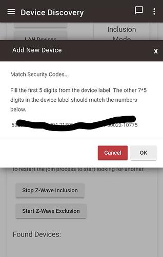

So I've just added to GE Enbrighten Dimmer Switches. The first went great, and it identified itself and works great. It used a neutral wire. For the second, I got the version that doesn't require a neutral wire. But that only shows up as a "Device" by default.
I noticed my first device was setup with "None" security, so I tried playing around with security levels on the second switch, but regardless of what security level I tried, it came back as "Device".
I did notice that when asked to enter the 5 digits on the front of the second device, the screen showed all the digits, and I didn't seem to have any place to enter any digits, and just listed all the digits! (Screenshot attached)

That just means the in-box driver doesn't know which driver to pick. This can happen for a number of reasons - rebranded models, slight updates where they changed the firmware/id, etc.
As long as the S2 pairing completed successfully, then manually changing to the GE Enbrighten driver, hitting save, then hitting Configure should be a perfectly OK thing to do.
