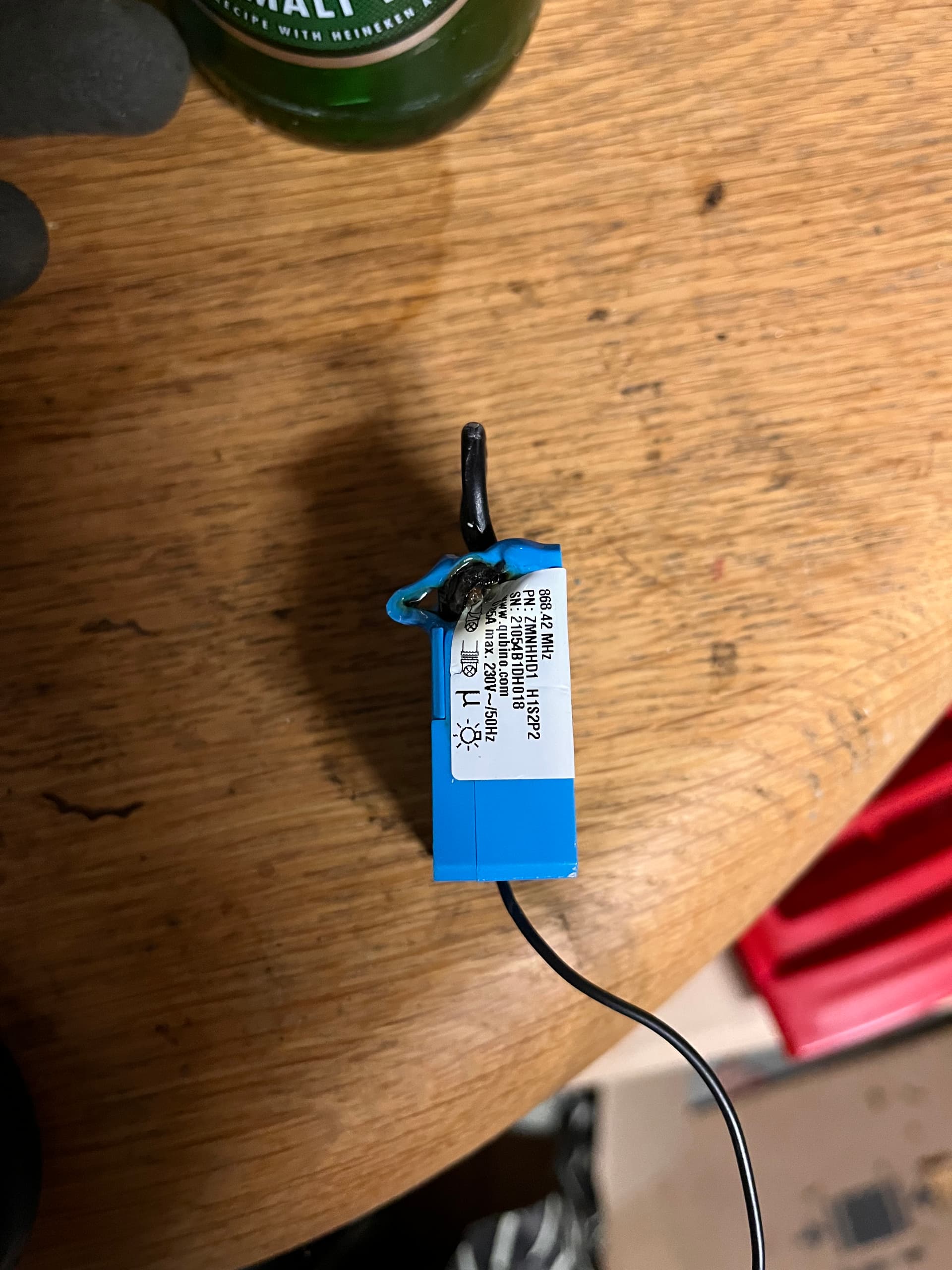

Using those Qubino Mini dimmers around the house. And last week I finally got round to installing one for the porch light. According to the manual you can install them with our without a neutral wire (3 or 2 Wire setup) This was the first time I tried the 2 wire setup without the N wire. Installed it and went to pick up the kids. Got back half an hour later and smelled this electrical smell you don't want to smell. It nearly burned the friggin house down ! scared the crap out of me !

I would certainly call the manufacturer and find out what's up...I would also check the wiring for that porch light...

Indeed send them a support request and asked what could have gone wrong. As far as I can see I did everything according to the manual. It's a standard bulb reasonably new wiring. The only wiring that was in the box was the Phase wire and the Switching wire according to EU/Dutch regulation. Nothing fancy.
What about voltage/amp/frequency? (Not sure what freq you run over there) Is it 50 or 60? What was the unit rated for? Also check your switching wire and make sure that it's not somehow backfeeding power.

230V 50Hz with a max of 16Amp (3680W) In the past it was 220V, due to European regulation it has been changed to 230V so all country's are the same within the EU. Did an check on backfeeding when installing the dimmer. None of that was going on. I really wonder what Qubino support has to say on the matter.
Yeah as long as the rating/freq is correct and no back feeding on the power that "should not" have happened...
