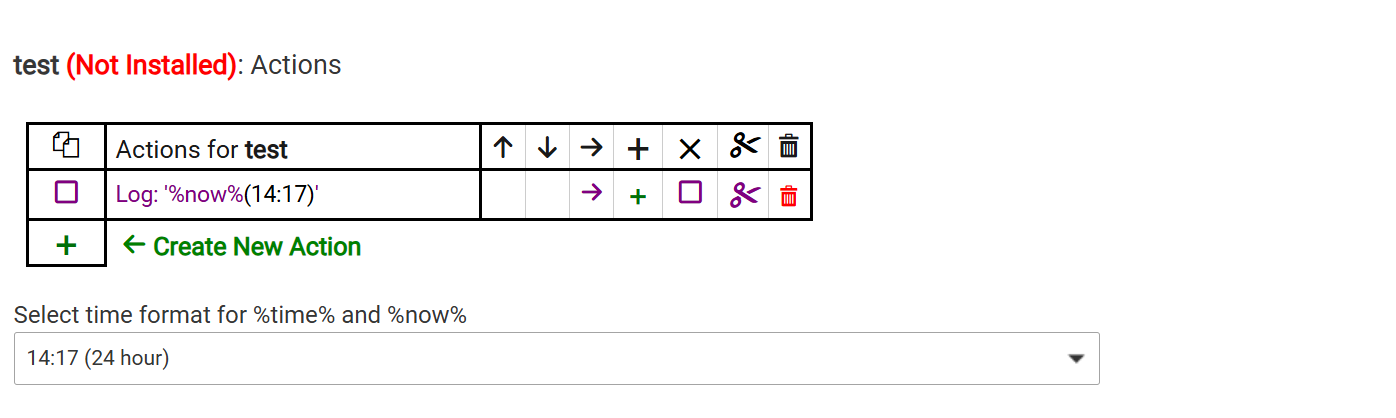

Not to burst your bubble, but you don't need to "create" a %now% variable or the associated rules to set it as it is all native. The %now% variable is a native, built-in variable, just like %date% and %time% are.
If you need a similar variable for a different purpose than the built-in %now% variable, I would recommend naming your own variable something other than %now% to avoid possibly interfering with the built-in variable by using the exact same name.
I dont see a way to use that in a variable comparison in a rule. There is a dropdown provided with existing variables and no way to type an arbitrary one.
I did not try to create a local variable named %now%. I doubt that would work.
You might be right about the naming collision.. Something to watch for.
It would be very convenient to have the %variables% available for use in the dropdowns.
