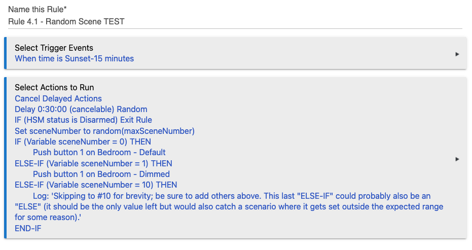

A rule that looks something like this should do what you want. The most helpful feature is the ability to use the "variable math" option when setting a variable to assign a random value to it:
Some comments: the scene will effectively be set at some random interval between sunset-15 and sunset+15 (i.e., the total time between the earliest time the delay could be up, which would be immediately after the rule triggers at sunset-15; or the latest the delay could be up, which is 30 minutes; most times, you'll get a value in between those two times). This could be simplified a bit if you want things to happen at the same time every day, but this is one way you can get in the time randomization that it sounds like you wanted.
Them, it checks if HSM is disarmed; if so, the rule exits (i.e., no further actions run). This is a "simple conditional," but you could expand it into a full IF THEN if you wanted to check for something more complex (i.e., not being armed to any of a few different modes, for example). Since you said you're not using HSM at the moment, you can probably leave this out for now--easy to add in later.
Then, we get to the "random scene" part. The trick here is creating two local variables, one to hold the "scene number, and the other to hold the maximum number of scenes you want, minus one (more on that in a second). In this example, I chose 10--which is actually 11 total since this starts counting at 0. These variables are sceneNumber and maxSceneNumber, respectively, but you can call them anything. They should be of type "number." (You actually don't need the maxSceneNumber variable; you could just use a literal value--the maximum number--instead of this variable on the "Set sceneNumber to random..." line, but I think the intent is clearer if you do it this way. Imagine yourself trying to edit this rule half a year from now.) The "Set sceneNumber to random(maxSceneNumber)line will set thesceneNumbervariable somewhere between 0 andmaxSceneNumber`, so in my example 0 and 10.
The rest of the rule just checks for the random number, which has now been assigned to the sceneNumber variable. To activate the CoCoHue scenes, I am calling the "push" command on button 1 (treating them as buttons). You could also use the "Turn on" (treating them as a switch) action, though I generally recommend the former for reasons you may have read about elsewhere by now.

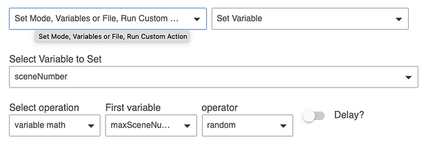

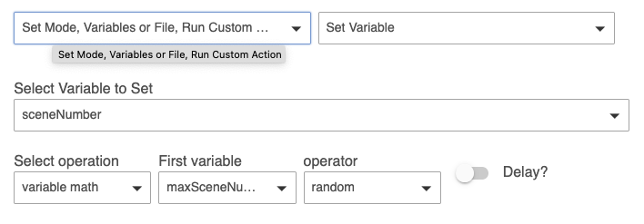

Now how do I get "Set sceneNumber....." ? I went through the list of choices, looking for something that involved setting a variable, but the closest thing I found was setting a private boolean to true or false which I don't think is it.
I may have forgot to mention: you'll have to create two local variables for this to work (or global, I guess, but you might as well make them local unless you have a use for them elsewhere). This is done from the variables section on the initial page in the rule, so you'll need to do it before you go into the actions page. However, there, you should see options to set a variable (it's possible these actions are hidden unless you have variables, otherwise the docs can tell you where any action is found).

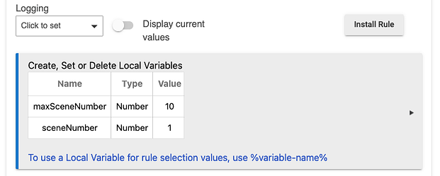

where do I set local variables? I only see the option to set a global variable.
To create local variables, use the "Create, Set, or Delete Local Variables" section at the bottom of that particular rule:
To set a variable in your rule actions, it's the same for global or local variables, under the "Set Mode, Variables or File, Run Custom Action" category. Here's what it might look like for one of my actions above:

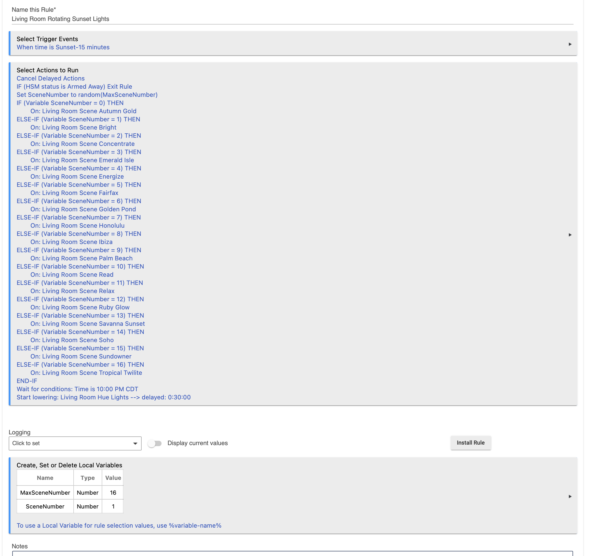

Here is what I have.
This will fire about 15 minutes before sunset, checking first to make sure HSM is not in Away mode. There are 17 possible scenes, and going from 0-16 it will turn on one of the designated scenes (I didn't do the button method you mentioned because I didn't fully understand it). Then around 10 pm it will start dimming the lights to nothing over about 30 minutes.
Does this look right to you? Assuming this works, I'm thinking about creating different versions of this rule for each season, and perhaps time of day also.
That looks like it would work to me--mostly! (The button thing is under the category with "Push a button," and you'd specify to push button 1, but the "on" command does the same thing with this device, so really either way would work.)
The "mostly" part comes from that "Start lowering" action, which will not work as you describe. What this does is send a startLevelChange(down) command to the bulb/group. You can test this on the device page to see what it does. It's great for using with a button device that you want to act like a dimmer (often paired with stopLevelChange() on button release), but it's unlikely to be what you want here. It also won't happen over 30 minutes. The action itself will just be delayed by 30 minutes (the "delay" feature you used here is available to all regular Rule actions and just schedules it to run at that point in the future). It sounds like you may want to use the setLevel() command with a destination level of 0 and a transition/fade time of 30 minutes (or 1800 seconds; the command itself accepts seconds, though different apps may present this differently, and again you can test this on the device page). This timeframe is a bit long but still within the specs of what Hue bulbs are reported to accept, and setLevel(0) is itself an odd command that may not work as expected (turning off the bulb) in all drivers, but I know this works like you want in CoCoHue (again, can't vouch for other drivers).
One other odd thing--which won't affect the behavior of your rule--is that your last couple actions wait for a specific time, then delay 30 minutes. You could just wait until 10:30 instead of 10:00, and the outcome would be the same (in this case; not sure if you were planning on adding more where this might make sense). Also, the "Cancel Delayed Actions" isn't really needed at the start of your rule since you don't have a random delay after your trigger time like I did, which would really only be useful if the rule re-triggered while that was still counting down, so honestly, I probably really didn't need it either in real life. :slight_smile:
