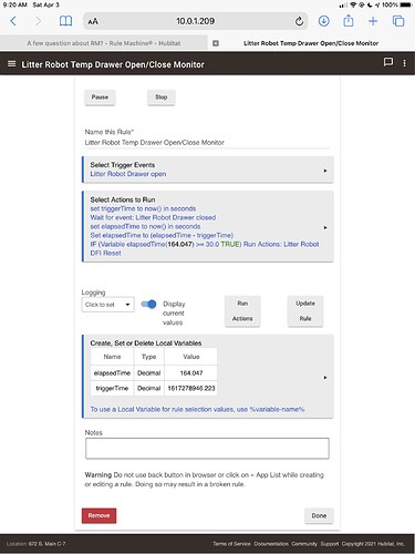

See, for example, my rule to call another rule if a contact sensor detects that the Litter Drawer has been open for 30 seconds on the Litter Robot, which needs to measure elapsed time in seconds.

  2. Since a system variable is available, you may not need to put it into a variable at all. However, as the example just above this illustrates, an exception is when you need to do time math with it. There is probably nothing wrong with making it a global variable and have the rule as you show, but why not just set a local variable "just in time" (pun intended). That is, set a local variable to current time then do the math.

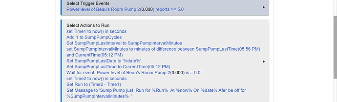

@672southmain here is a rule I been working on to see how the sump pump runs and the time between runs
Looks good. Do you have a problem with retriggering if the pump switch bounces on and off?
Hi, @672southmain
in some tests, I have seen a problem of if the pump switch bounces on and off
I am not sure how to fix it?
