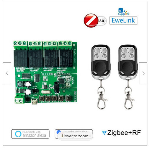

I am struggling big time to get the included Remote control to this Zigbee smart switch to Pair, have any of you any manual or can guide me how to get this unit into Remote pair mode, it connects perfect into HE, Zigbee, and i can control all 4 switches form dashboard and from device, BUT cannot find anything how to get the remote to work, if i hold the mode button or hold any of the manual 4 switch buttons the unit goes into Zigbee Pair mode, but i have not figure out how to get into Remote control Pair mode.

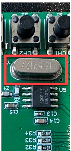

Seems to trigger random commands to the board, now I will supervise how the Zigbee portion behave, so far been having zero issues when it comes to Zigbee side of it, the random commands, in my case was from 433mhz command signals, ( Log file in HE is clean when it comes to anything form this unit)
I don't care about that if the Zigbee works.
