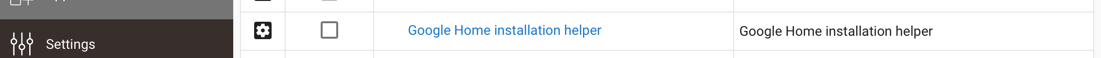

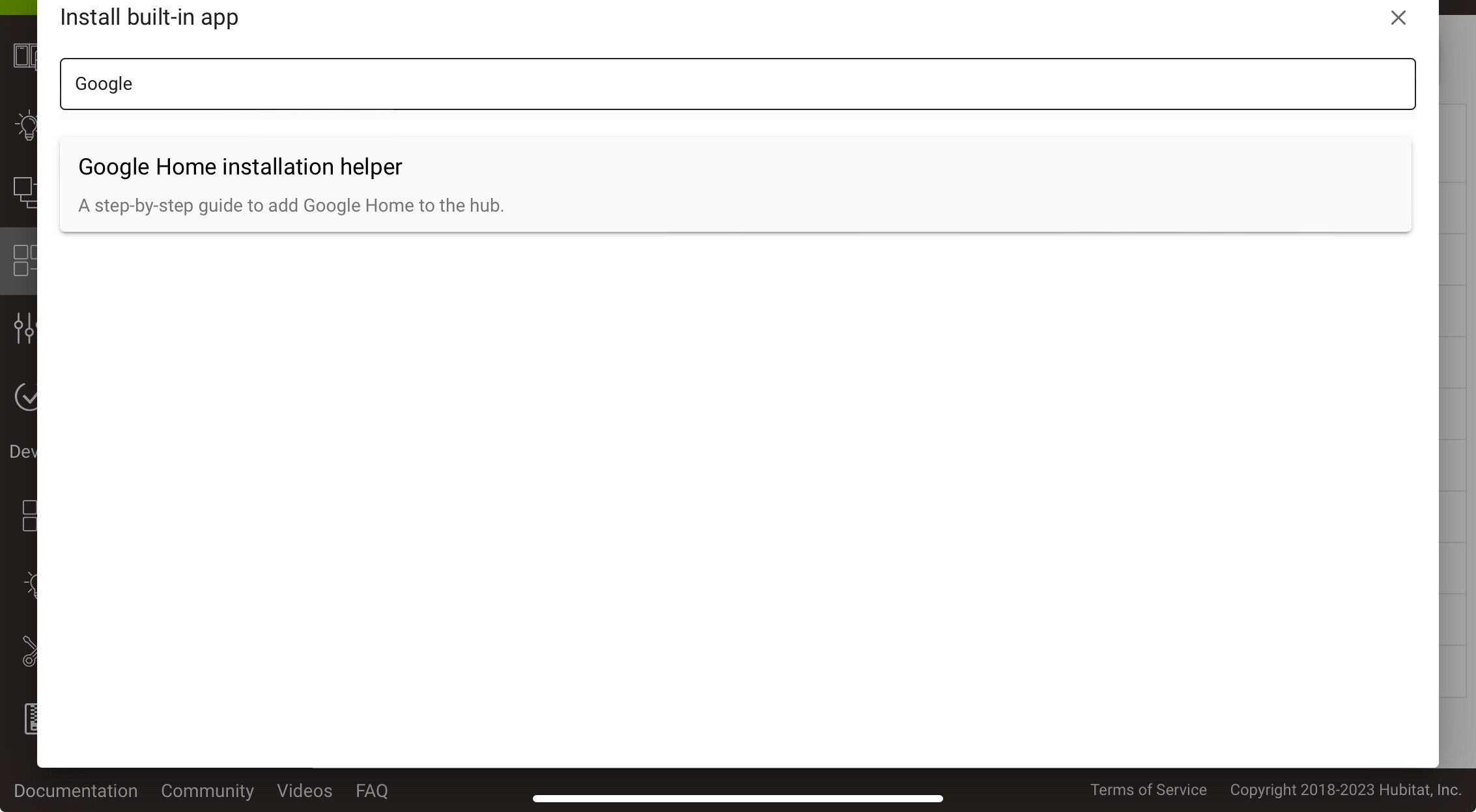

It is the Google home installer helper or is there a different app? It doesn’t show any devices to select.
I am not really sure what that app does you have there, the one you want is just called "Google Home"
I don’t have that built in app.

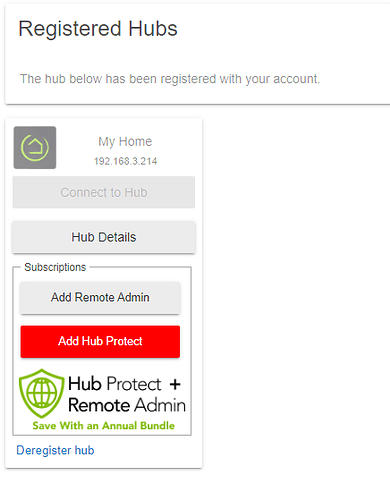

Also I think the registered hubs page here: My Hubitat if the hub is offline everything will be greyed out? Cannot be certain on that one though.
https://my.hubitat.com/hubs
It is showing this on my hubitat page.
It shows this when you go to HUB details.

When it is greyed out like that I think its means it is not connected.

The most convenient way is to check the notification in the upper right corner of the hub's web interface. There should be a message stating that hub lost connection. Based on recent incidents it appears that the messaging system may not be working as expected. We are looking into it.
...it also means that the mobile device may not be connected to the same network. So is not 100% accurate that hub isn't connected to the cloud.
I tested it on my PC while on a VPN so the hub was unreachable due to the VPN, but it will not greyed out. But I was still on the same LAN so maybe it thought it would be able to reach it? Thats why I thought it might be a good indicator.
