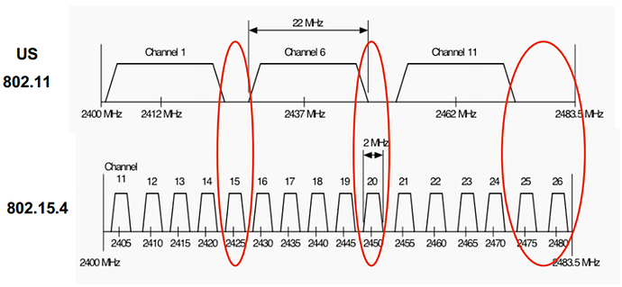

Each Hubitat hub creates its own Zigbee mesh network, and thus each will need its own Zigbee channel. Using folks choose Zigbee channels 15, 20, and 25 to avoid proper configure 2.4GHz WiFi. 2.4 GHz WiFi should be configured to use channels 1, 6, or 11 with a 20MHz channel width.
As you can see from the illustration above, these settings will result in minimal radio frequency conflicts.
Hope this helps!

What's the channel width? Is the 20 MHz or 40 MHz? I would suggest setting your 2.4 GHz WiFi channel to 1. And the width to be 20 MHz. This will ensure no interference with zigbee channels 15, 20, or 25 - as detailed in @ogiewon's post.
