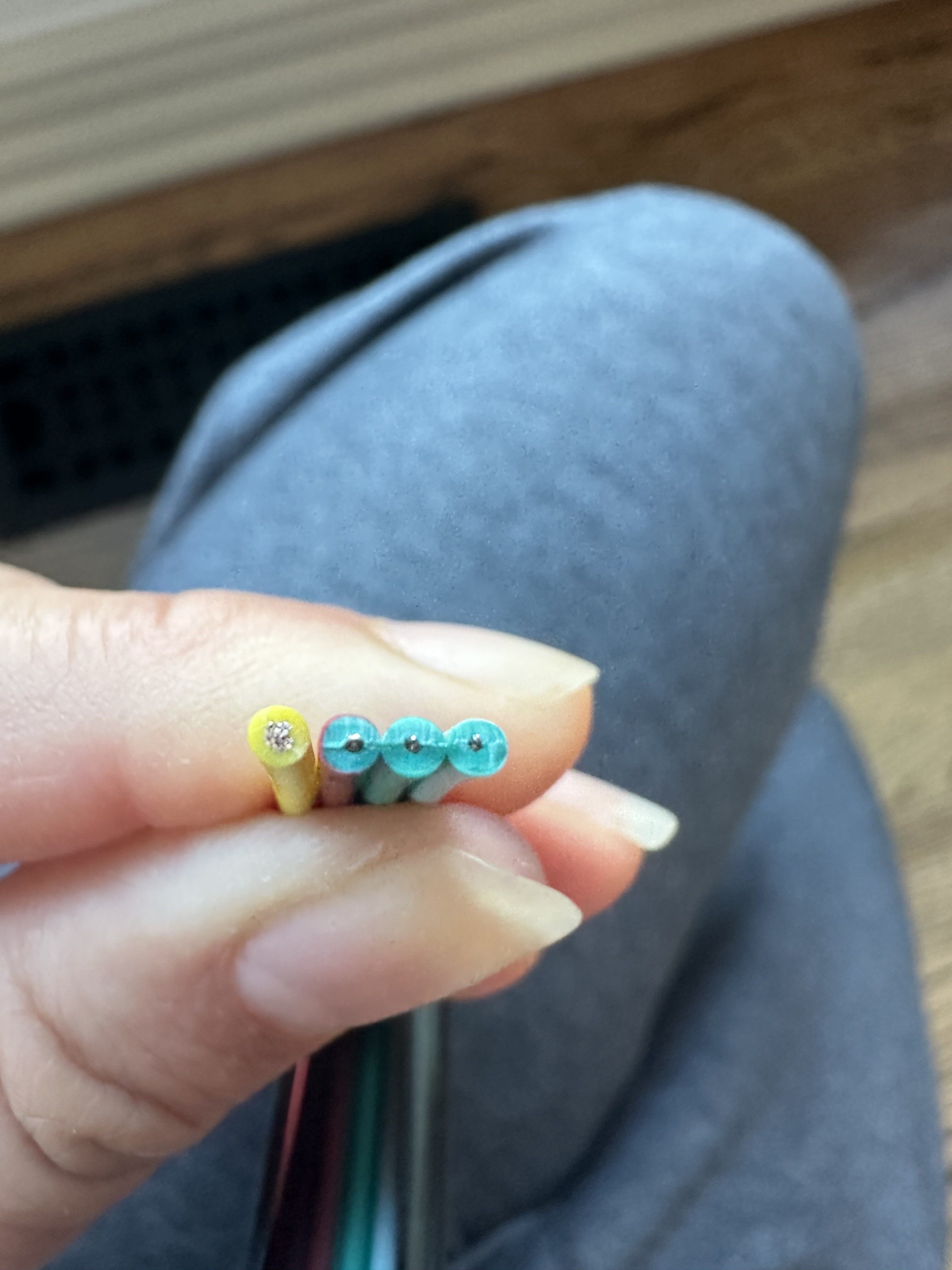

Looking for recommendations of 20AWG conducting wire for LED strip projects please that can be purchased from Amazon (ideally a 3-wire). It seems to be such a hit or miss. This is a 3-wire one I bought and there’s like maybe 5 flimsy strands in there :joy: If you do the tug test on it, it just rips away :upside_down_face:
For reference, the yellow wire on the left is my expectation (took it off something else) and the 3-wire on the right is what I got.

20 is an odd gauge and you will mostly find smaller 22AWG since it’s used a lot with security systems or larger 18AWG since it’s the minimum gauge speaker wire.
I personally use 22AWG wire for most of my LED projects as a buddy gave me a box of security wire he had left over. It works great for a variety of projects and is rated for pulling in walls when I need to put the transformer in crawl space.

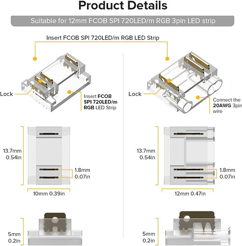

I think 22AWG will probably work, too. I'm using those no solder connectors for the LED strips and the ones I have calls for 20AWG, but could possibly work with 22AWG, too?
Those should work but those really depend on the outer wire shielding since they puncture the wire. I personally use "b connectors" that I learned about from my buddy who used to own a security/AV company. You simply twist the wires and then crimp the b-connector over the wire. They make outdoor rated ones too that have gel in them. Example:

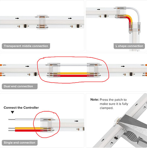

I'm talking about connecting LED strips to the wires though without soldering. I assume the wires need to fit in the holes of the plastic connectors. I have essentially 3x 4-foot segments for uplighting on our barshelves that need to be connected together via 30" long wires like below:
I usually just use screw wire nuts or Wago connects for a wire-to-wire connection.
