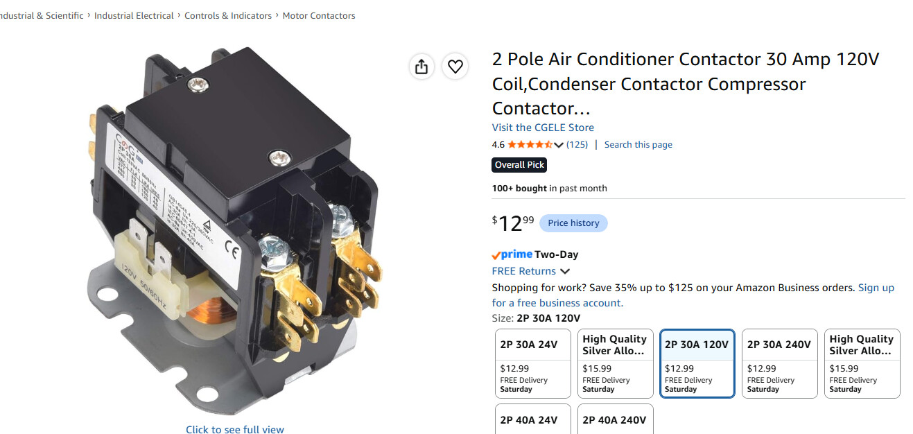

I would just use a 120v coil contactor that is triggered by a smart plug or a relay. You can get a 30 Amp for $13 on Amazon.
