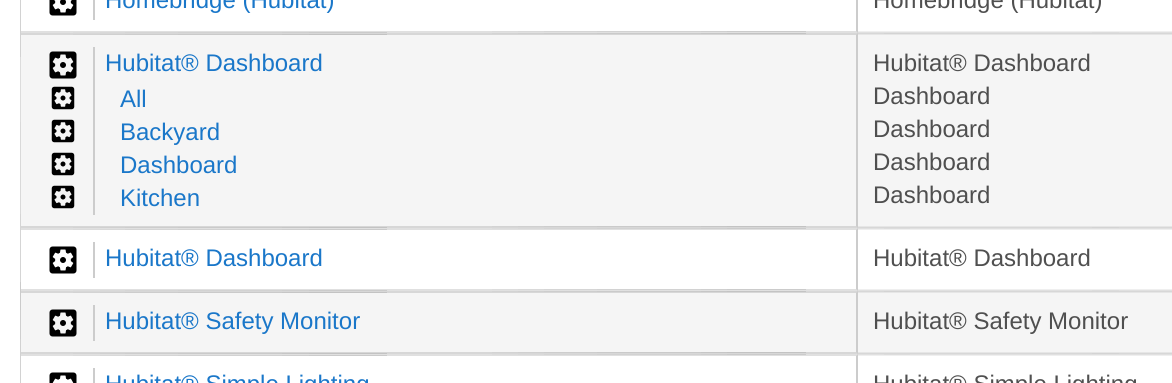

@patrick I seem to have 2 of the new ® Dashboard apps in my list.
I hadn't noticed it earlier but would this remove both if I remove the "unused" one?
Please update to the latest version.
I had already updated first thing this morning to 2.07.124
If you remove the unused one it should be fine. Of course, can't hurt to take a backup just in case.
It removed successfully. Any reason I could have had 2 installed apps. After I removed it, I went back to see if I could install it again ,just to test, and it didn't. ????
It was due to the duplicated Dashboard in release 121.
Thanks!

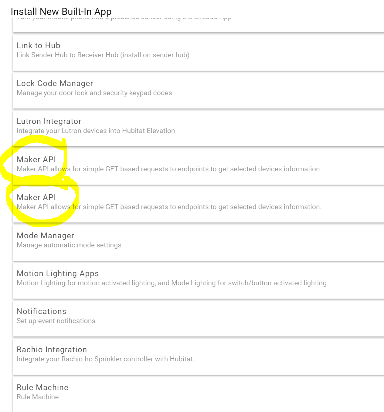

I have two maker API built in app, and have for months. When I press add built in app, I get it twice there. Not sure what it means.....
@patrick
Maker API allows for multiple installs.
Yes, I know, appreciated. But I'm talking about this...
Are you on the latest release? And a C5?
Latest release, C4. Been like that for months....
@patrick
@patrick C4. Didnt fix with the update yesterday. Latest patch.
