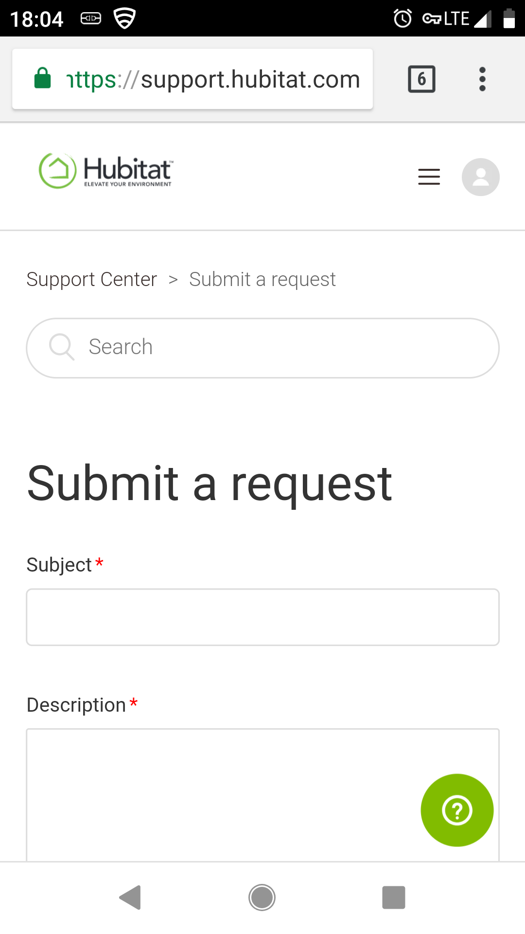

https://support.hubitat.com/hc/en-us/requests/new
