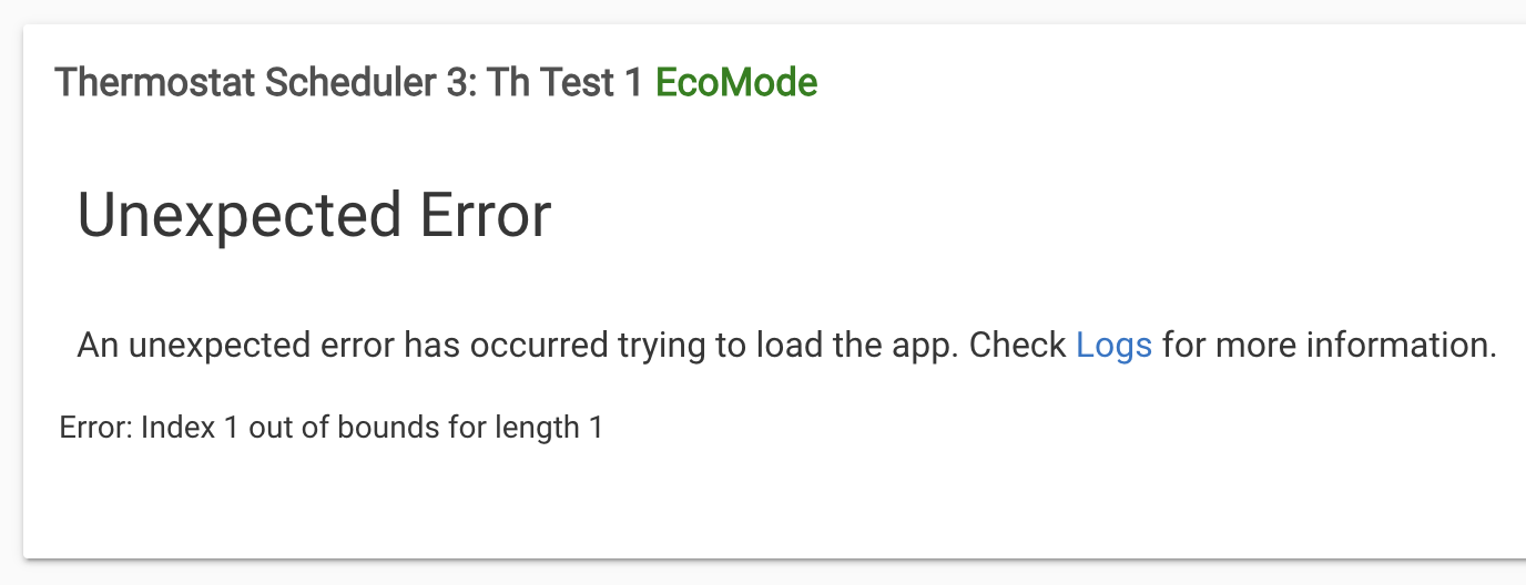

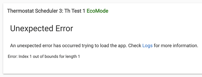

How I found it: an app of mine cleared a DateTime variable with setGlobalVar(name, "") when it had no date to store. A Thermostat Scheduler period whose start time used that variable then made the scheduler's page throw an ArrayIndexOutOfBoundsException every time it rendered. The Hub Variables page shows that value as **bad DateTime**.
