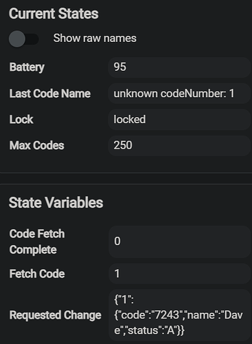

I replaced a faulty lock "Back Door" and tried to send the codes to it; only one arrive and the other is always rejected as Duplicate.
I finally gave up and factory reset the lock to start over.

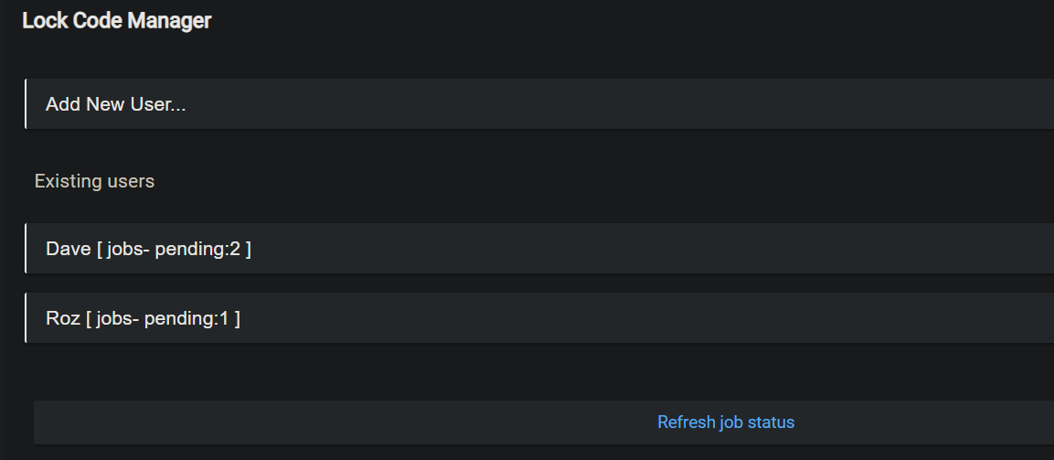

I added the codes to the user/lock in the app and it just sits there, always Pending and usually hung there, the Device waiting for the Add to happen.
The strange thing is I have tested all 3 locks and both codes are in the locks and working so it appears the Add happens and the app hangs as you can't have a duplicate entry.
Is there some way to sync the app with the locks?

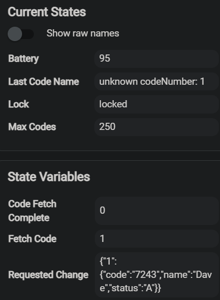

As you can see no actions Pending for the device but Pending in the app for the new Back Door lock:

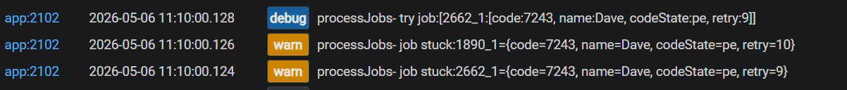

And a stuck Add for another:

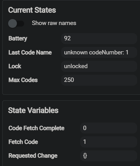

While the 3rd has populated:

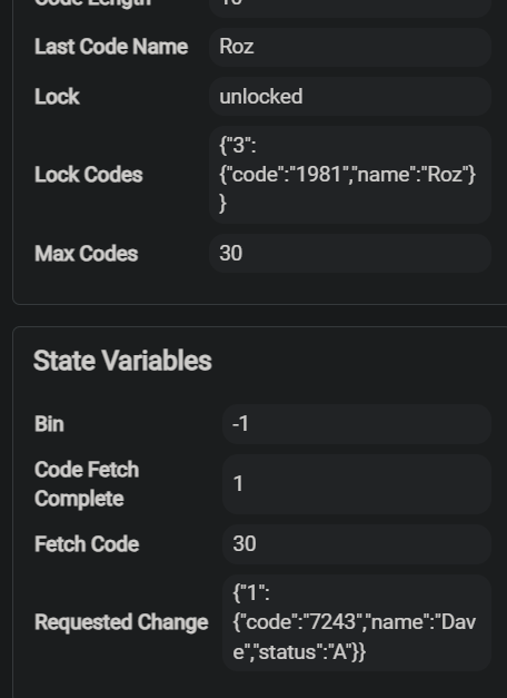

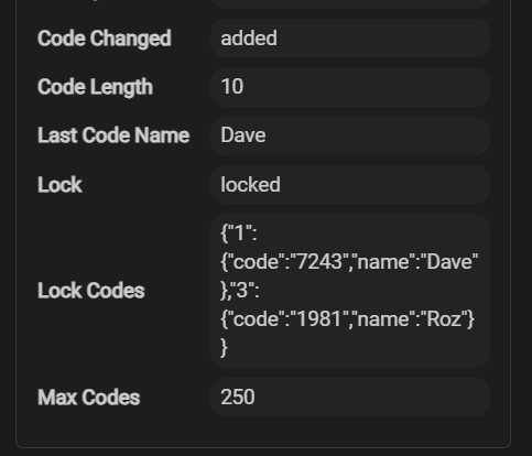

My empty lock, according to the Driver.

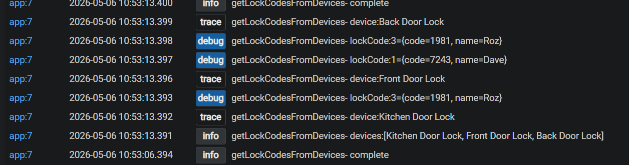

I did a Debug get of the codes and they are there.

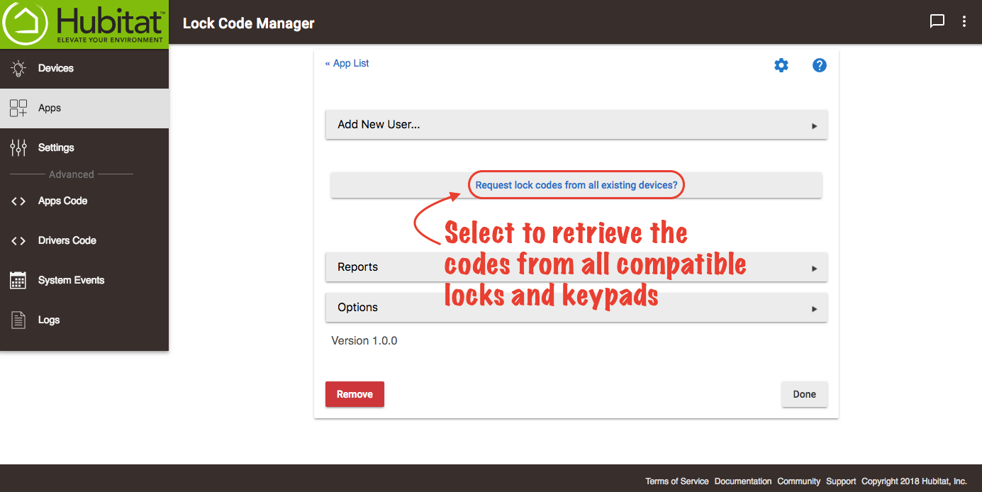

To sync the codes from the lock:
Where is this magic? :wink:
I don't have this unless I have to delete all the users first and start fresh?

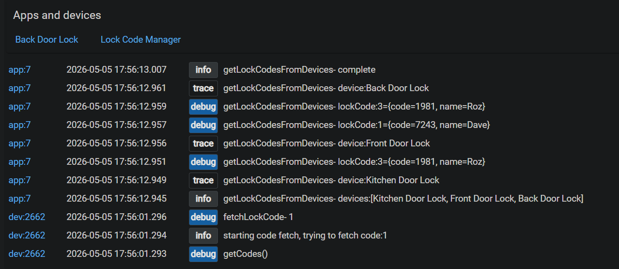

Lock app is a bit upset as well:
Seems to be able to reteive the codes though just not successfully write:

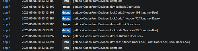

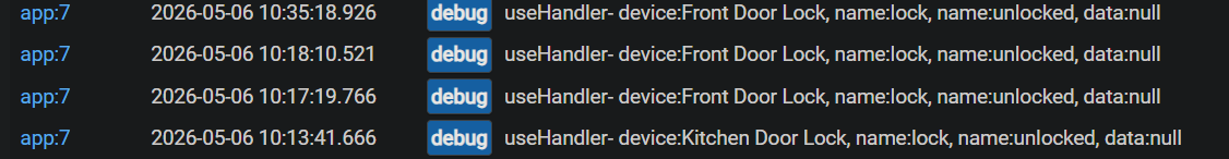

I removed the app and even rebooted but it comes back loaded with the old users and assignments. Logs show it queries the locks when I open the app.
My 3 locks all have 2 codes in them, I have tried each one for functionality.
The app does not populate with all the codes and doesn't like it when I try to push the correct entries.

No Request Lock Codes apparent.
It's quite possible that the app documentation is wrong. It's been a while since I last used LCM and I no longer actually have it installed, since my new Aqara U400 does not support anything code wise via Matter. I am fairly certain that should be an option, since there are many instance where you can have existing locks with codes setup before even getting a Hubitat hub.

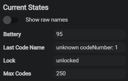

I have manually set 2 locks correctly. Just off to factory reset the new one as it won't even take code commands now as it's stuck on the 'unknown codeNumber:1 error.
All good now.
Manually deleted all codes, reset problematic lock to clear unknown codeNumber and rentered codes manully.
