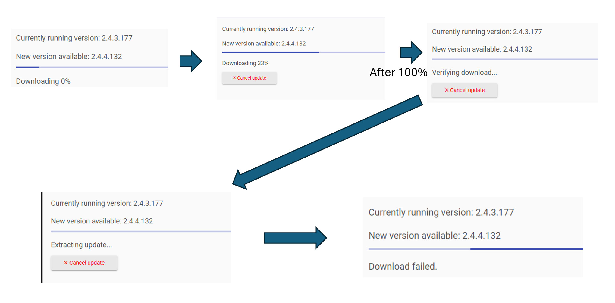

I have a C8-Pro and can't upgrade to the latest hub version via the default Hub Upgrade tool. I have seen that issue three times in the past as well. First time I experienced this I could reboot the hub, and then the upgrade went through without issues. The second time, reboot did not help and I had to go via the Diagnostics Tools, but eventually the upgrade went through.
The failure mode in "standard hub upgrade" is always Download ... -> Verifying ... -> Extracting ... -> Download failed

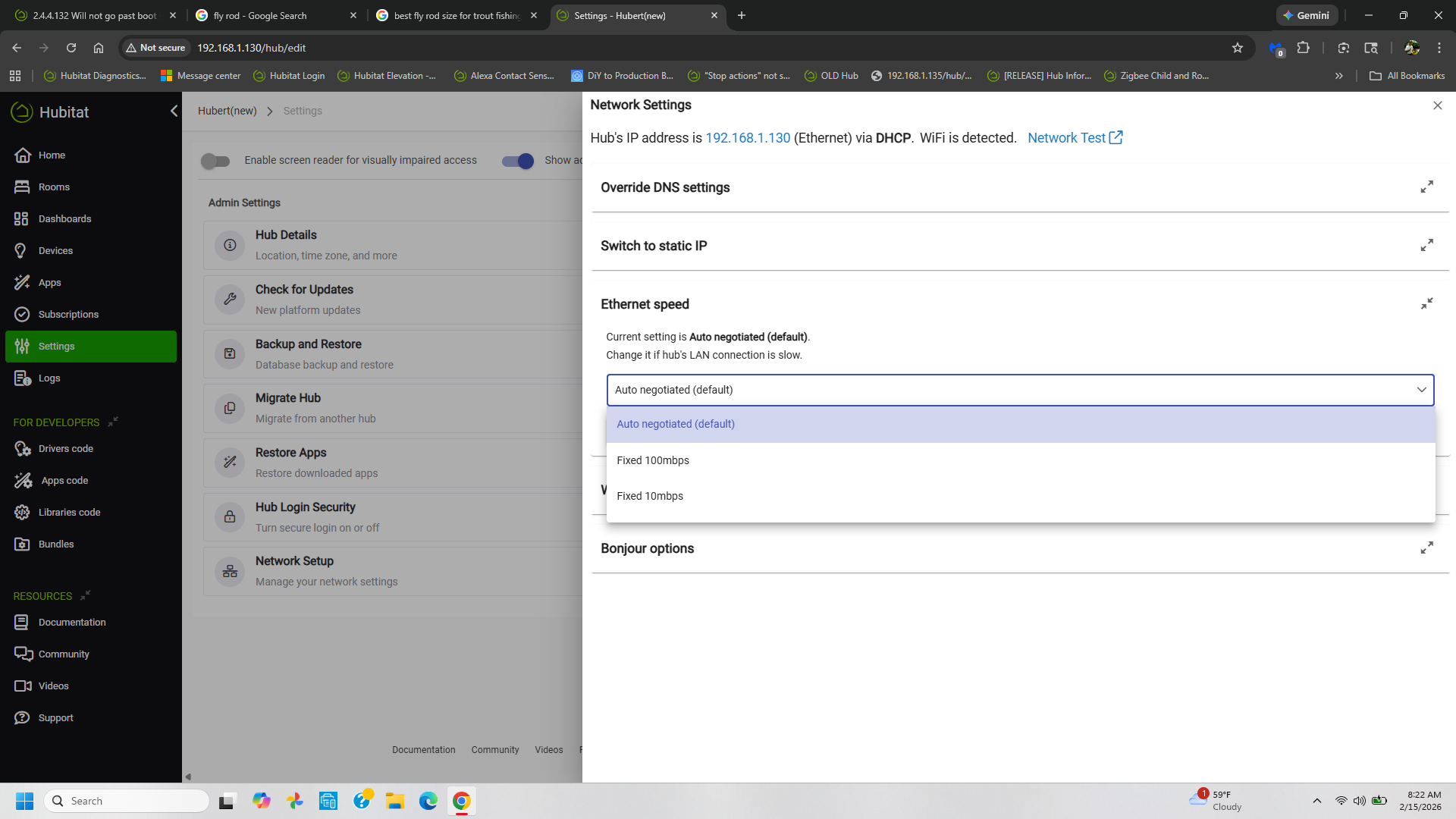

I don't know much compared to everyone else here but have you tried changing the ethernet speed in settings to anything other than what it is?
use auto unless you're going to strap the link settings at both ends
The advice in these situations (communication issues between hub and WAN) has been to change from the current setting (100 to Auto or Auto to 100) and try again. Changing the Ethernet connection speed setting seems to jiggle things enough to get the hub/router to renegotiate their connection and start working again.
From my enterprise gear networking days. Choosing 10, 100, or 1000 turns off auto negotiation. Unless the other end is the like wise set, it's attempt at negotiating will fail and so will default to 10 half causing the link to not come up. So either auto on both ends or strapped on both ends but never a hybrid arrangement. Was a bit curious hubitat exposed settings for 10-100 without also exposing the hdx-fdx options as well for when connecting through a hub instead of a switch.
Thanks for the suggestion, but I already went down the ethernet speed route several times without any luck I am afraid.

Yup - I'm not the guy to try to explain why it works, but it does, consistently, clear up communication problems where the hub isn't completing platform FW downloads in particular. Might help here as well, but :man_shrugging:.
