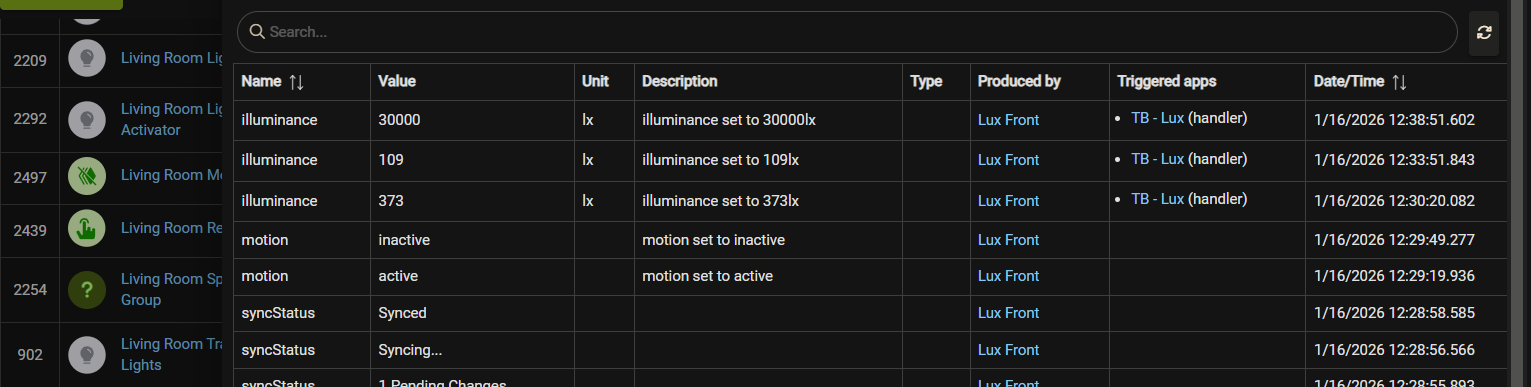

[2.4.3.177] C8Pro JS Zooz ZSE11 reporting false illuminance values
As of today my Zooz lux was always 10000-30000 in direct sunshine; it was yesterday.
Today it's lucky to get 4-500 and as I type this it's down to 109.
Tried rebooting the device, config, refresh but no change.
The driver was changed.
Any suggestions before I gfo forf a full power off/reboot of the hub?
EDIT:
I posted this and seconds later the lux jumped to 30000.

Interesting, just did it again.
Ok here:
Wrong here:
Recovered here:

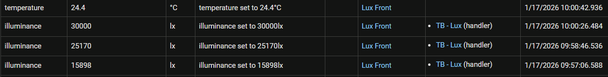

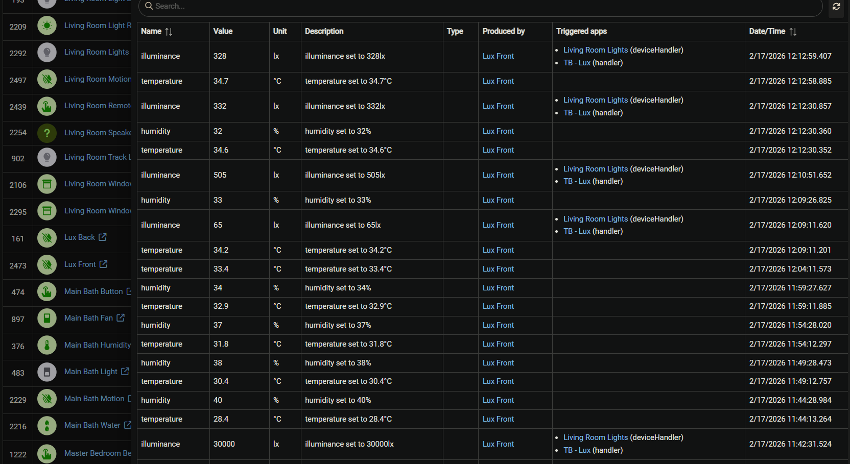

Still scratching my head on this one, maybe the device is faulty.
Full sun and 300ish lux. An hour before it was 30K.
Power cycle and back to 30K within a couple of minutes.
The only real change was FW 2.10.
Trying the built-in one for a while which I suspect is based on yours? @jtp10181

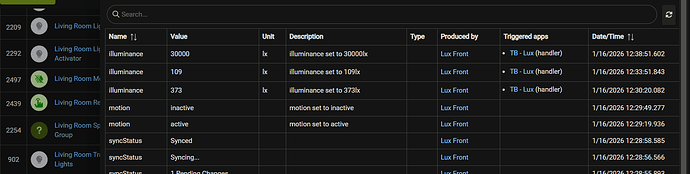

I dont see any lux reports in your Zwave logs up above.
If using my driver you need to enable Trace logging to see the full message sent to the driver from the zwave stack.
I had trace logs earlier in the post twice but I didn't see anything bad but I'm no expert on anything, ask my wife. :stuck_out_tongue_closed_eyes:
I could try swapping the back device with my front device and see if the one that never sees 30K white out conditions does the same thing.
There are no trace logs, only debug logs and zwave logs.
Only one of the zwave logs has illuminance in it, and there is only one entry which is not a helpful one. It is showing what looks like a normal change.

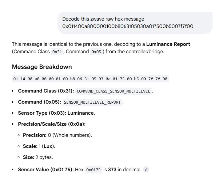

[Node 184] [~] [Multilevel Sensor] Illuminance: 534 => 373
Your zwave logs also have tons of extra spaces or tabs in them for some reason, even if I copy and paste into something else. So they are very annoying to look at.
I grabbed the raw hex for that one message and made AI decode it for me. This should be the exact message the device sent to the hub before Zwave JS parsed it.

The device seems to top out at 30K and possibly reset to 0 and start slowly incrementing again.
