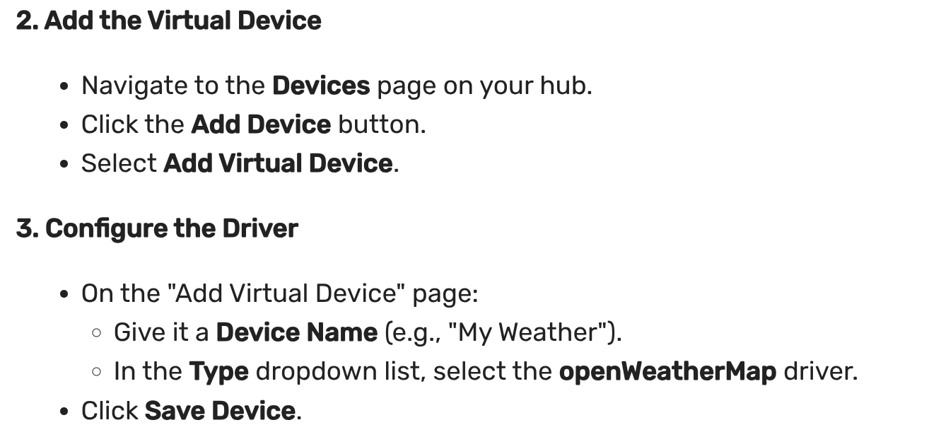

Add a virtual device. There is a drop down to select the type of virtual device. Which one?
OpenWeatherMap. It's not in the Virtual section of the Type listings, in case that's what may be tripping you up.

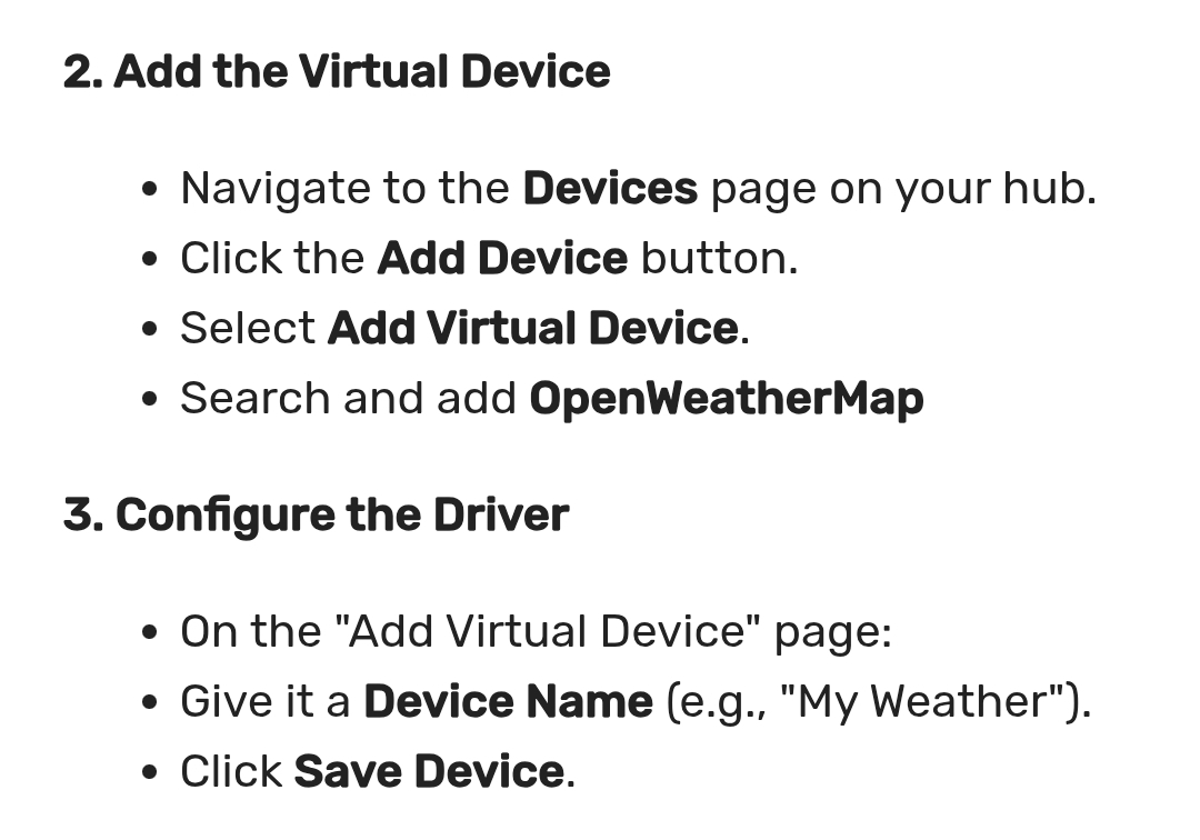

Where I went south is that you have to type openweather into the search box and select it before you can name it. It doesn't appear in the virtual list.
Is not, you, it's me. I messed up and forgot to indicate that you need to search or find OpenWeatherMap in the list of virtual devices.
I fixed my post.

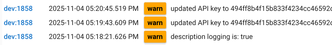

@bobbyD I'm getting a warning and setup required with my API key. I use it for other things so I know it is valid. Below is not the full key.
The community driver got the right attributes. I'll check how to expand the support without breaking anything.
That should be fine going forward. It's not an error.

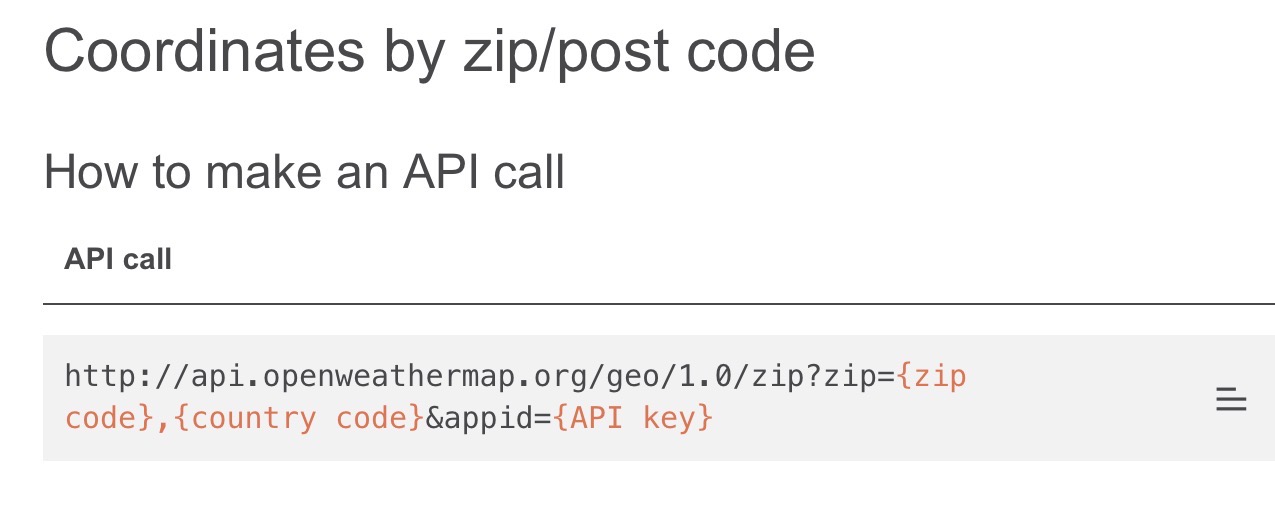

Any idea what the illegal character might be? Weather shows as setup needed.
url’s dont do spaces, so the space between United and States is defo wrong. w/o out looking deeper into the api there is potential the entire ”,United States” after the zip is unexpected/invalid/may cause errors.
Yep, United states is wrong per their API docs. Country code should be used instead of country name.
That's a solution. Removing zip code and country from the preferences page is the fix. I entered the zip code and chrome auto-filled "United States." Leaving both of those fields empty works.
