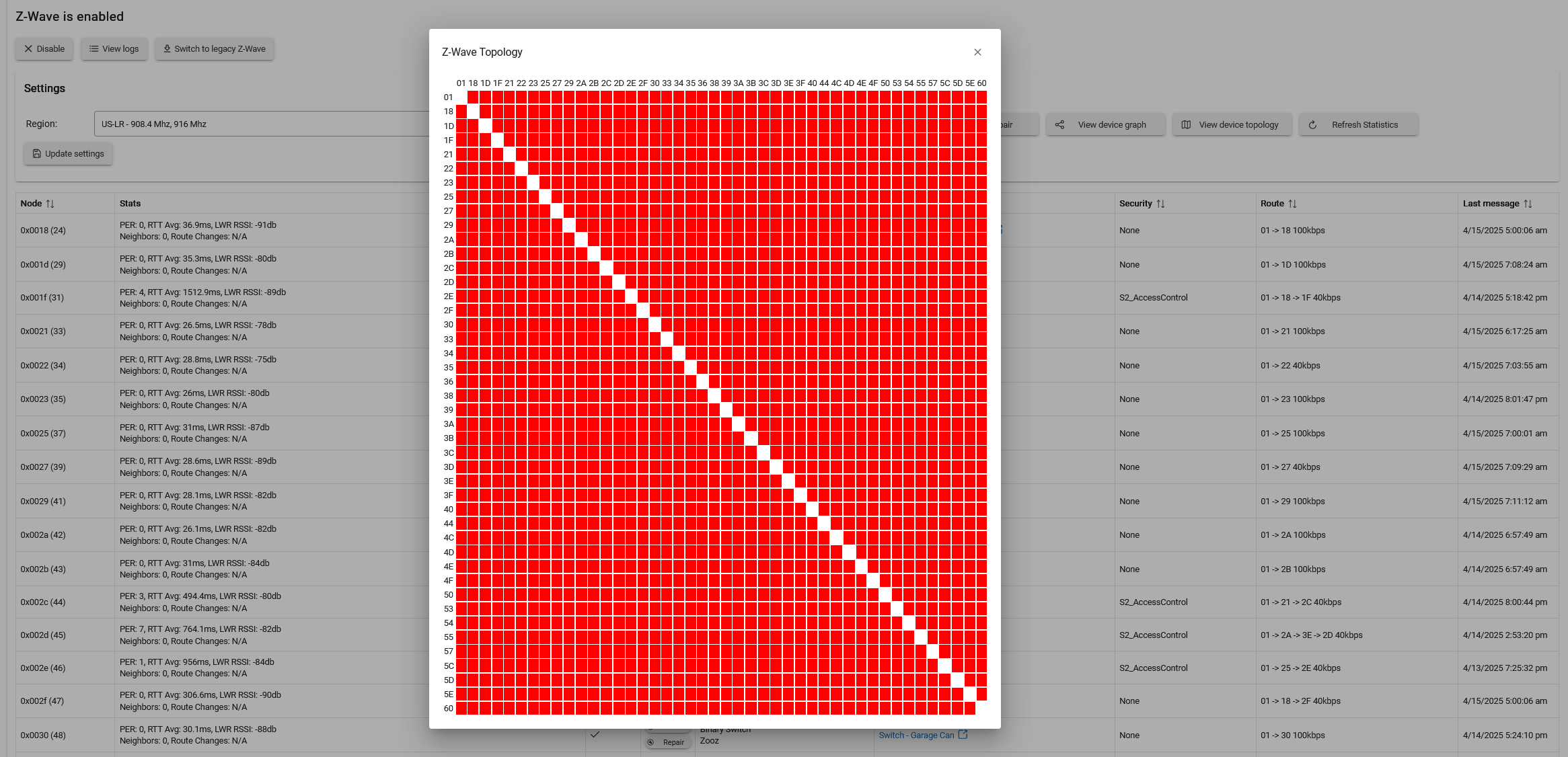

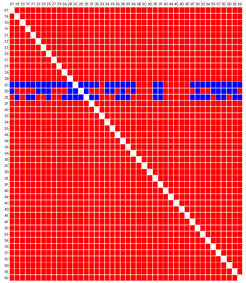

I gave it some time to settle down and then did a refresh statistics on the ZWave details page. Let that run for a bit and then refreshed the page. Every device shows 0 neighbors, even with populated routes. I used the re-interview command on three of my locks and then they showed neighbors:
Graph
Topology
It would seem that my ZWave network is a mess after the move to JS so I am looking for things to try next.
I ran a full ZWave repair which completed but I still have the same screenshot results for the details

Are the devices working? That is the important question. Some people have had the neighbor info missing but devices still worked fine.
For your logs you saved, you could post it to pastebin.com and share a link if you want. Not sure if they will be useful or not.
If you are having issues with devices not working, I would just switch back to legacy ZIP. It should go back to mostly working how it was before. Some devices may need to discover neighbors again or re-route but just be patient when switching back.
If staff engages here to work on a solution you can always switch back to JS again for further troubleshooting if needed.

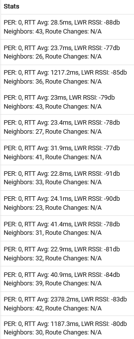

I just updated to 2.4.1.162 and after the reboot I am seeing neighbors again:
Probably a coincidence, I don't think Z-wave has been touched much since the initial 2.4.1 release. Maybe one other patch right away and that's been it.
I will keep an eye on it and see if the slow downs still happen or not.
After all latest upgrades I still have 3 devices with no neighbors and no route. They are working perfectly fine. After hub reboot about half of devices showing no neighbors and no rout but sure, they are working.
