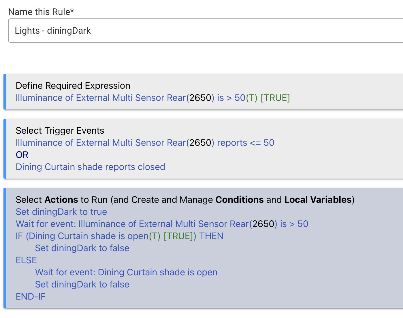

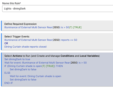

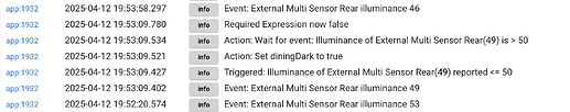

@bravenel - Just to follow up. I screenshot, deleted and re-wrote one of the rules from scratch:
Currently it seems to be working normally. As the curtain closes automatically at sunset + 15, the time of year and weather will affect which trigger occurs first (illuminance or shade closed). So far it's only been tested with illuminance and triggers/works as it previously did before .153 - so I'm guessing something got corrupted.

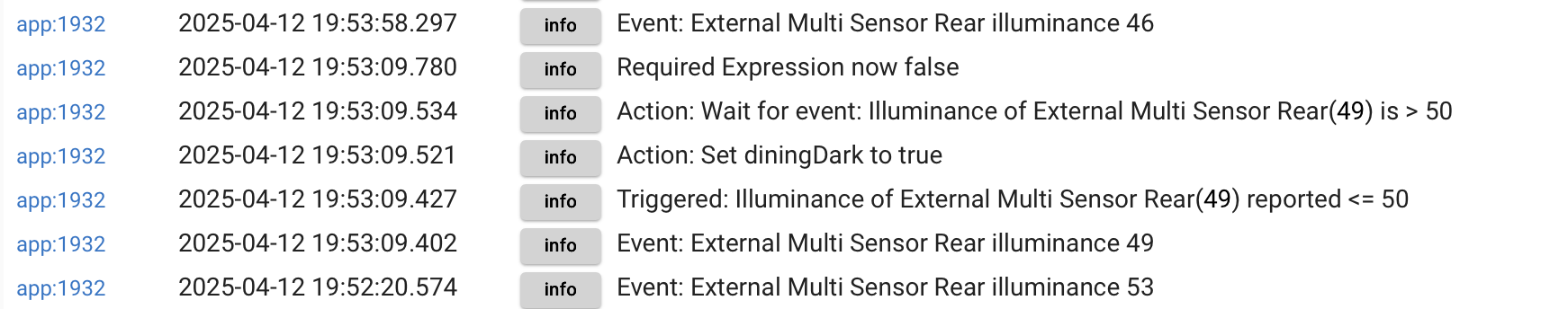

Light level dropped below 50:

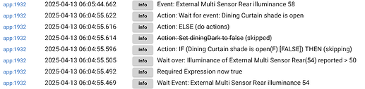

Light level raises above 50:

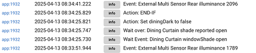

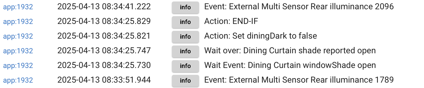

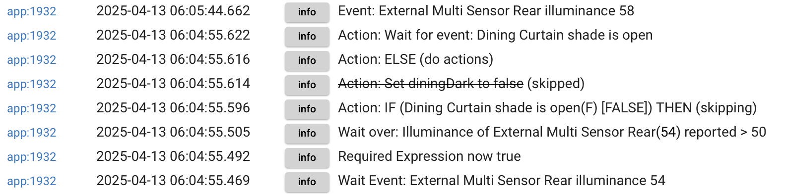

Completion of the wait:
