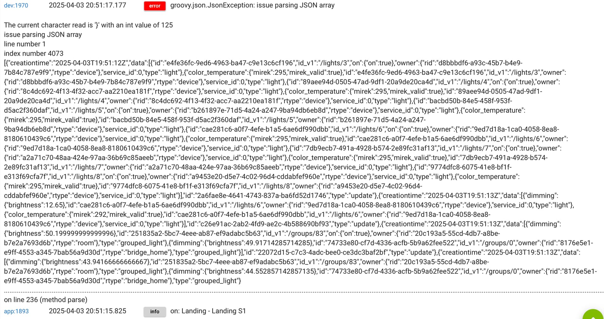

What I can also see is that after the first activation, the Hue Bridge integration (built in) threw an error, and that seems to be the start of the issue:

I don't think that is related. That would only relate to parsing state changes that come in from the bridge (and would be caught up on the next poll, just like used to be the only option), not sending commands. I don't see where RL ever tries to send the "off" command, though I can't tell why from your setup.
(For more on the Hue issue, see: Error code From hue hub integration - #4 by bertabcd1234)
