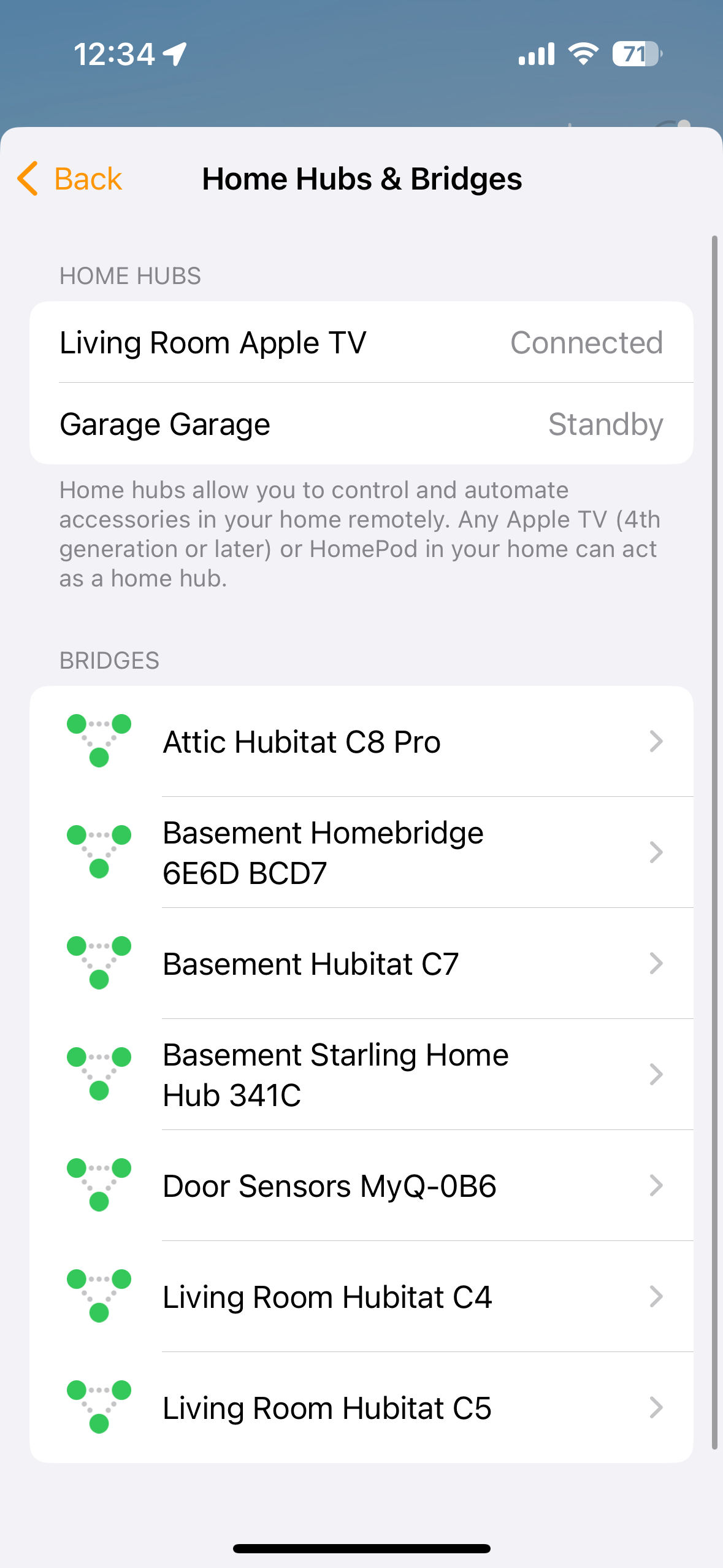

Are you using an Apple hub, Apple TV or HomePod, or just standalone iPad or iPhone?
Show us this from home app.

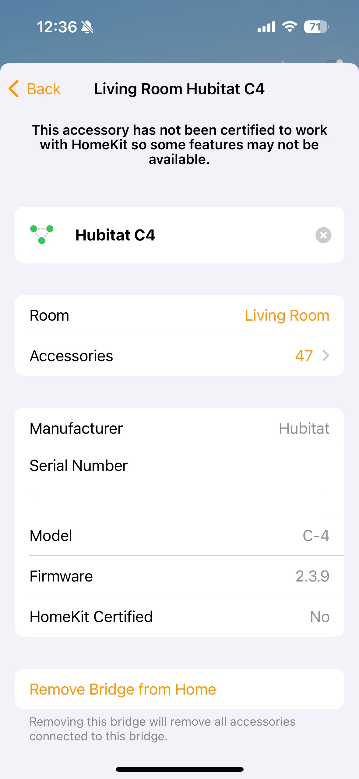

Do it through your homekit app... Click on the settings for each hub, should show the version.
They all show the same firmware 2.3.9

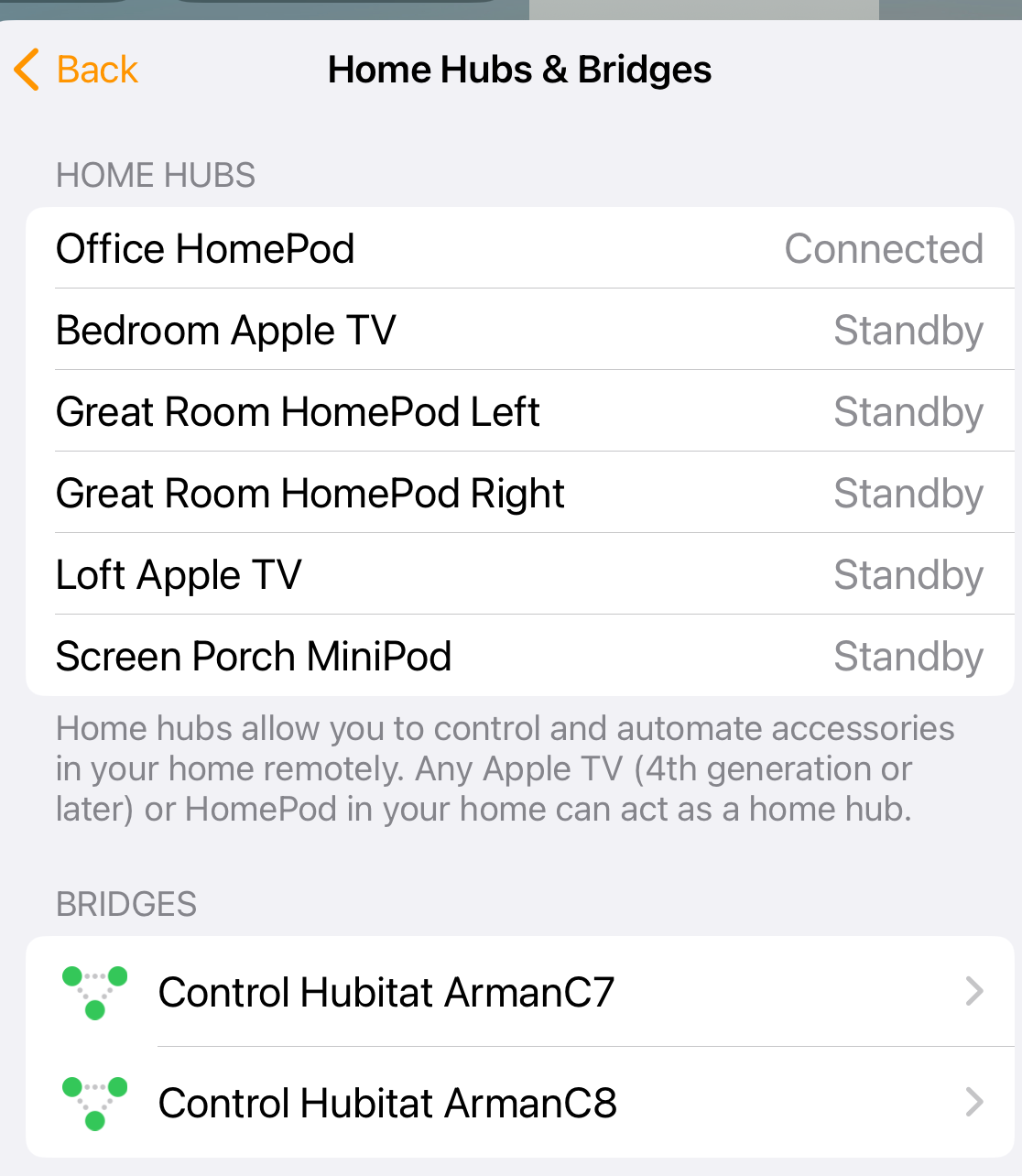

What firmware is your homekit hub(s) on?
Not 100% sure, it's the latest version of tvOS from Apple.
